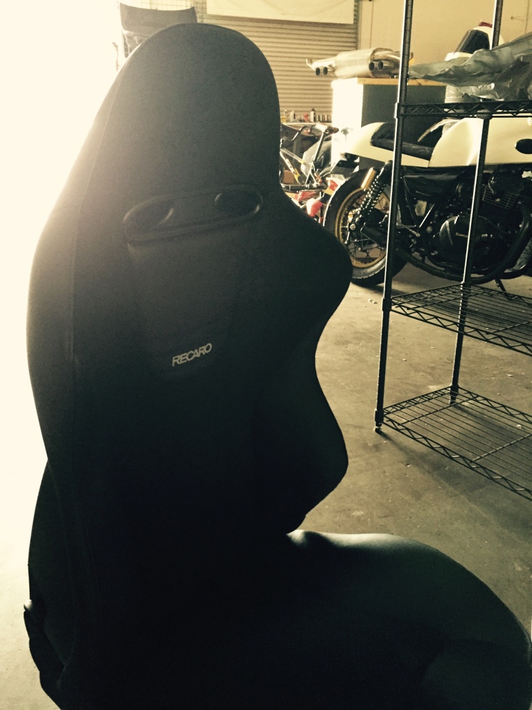

    Ohhhhhh man the seat is here and is being installed now along with a plus rear swap. I'm so pumped. Will report back with better pictures and some seat time[​IMG]

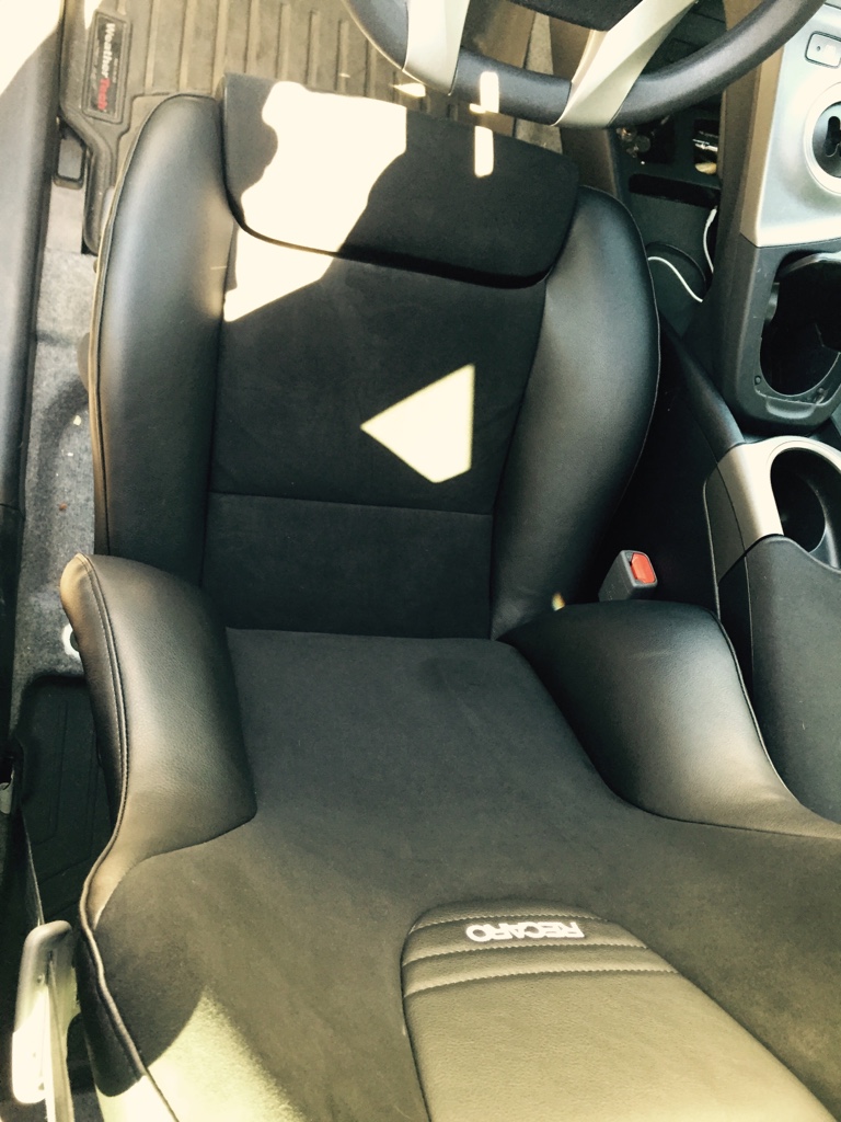

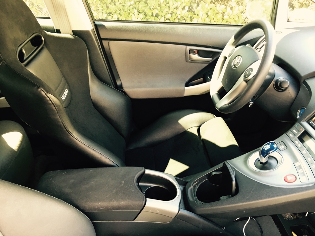

    Sweet! Recaro is in - and I am happy to report immediately the weird pressure in my wrist, shoulder, thighs and neck are completely gone. Only gripe is that the planted tree seat base is an inch higher than I'd like, but because the seat adjusts tilt while simultaneously lowering or lifting the tailbone area, the seating posture is still very comfortable even if it is an inch higher than I'd like. Vent function is so amazing, this is the first time I've worn business attire on a hot day and when I stepped out of my car my bottom was cold. I could get used to this....
    It's weird sitting in the car, and having it feel solid, simply because I'm not hanging onto the streering wheel for dear life during corners - and I'm not referring to the lack of bolstering in the stock seats, but rather the soft plush padding in the oem seats that I liken to a waterbed. Take a corner, side opposite the corner will deflate with the oem seats.
    Added a rear sway too and the car is less resistant to roll, but nothing life changing.
    As for seat comfort. If you guys drive like me 36k/year it might be a worthwhile investment. Totally love my car again

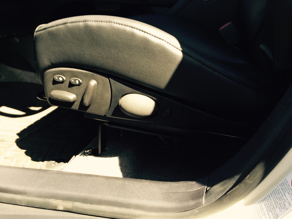

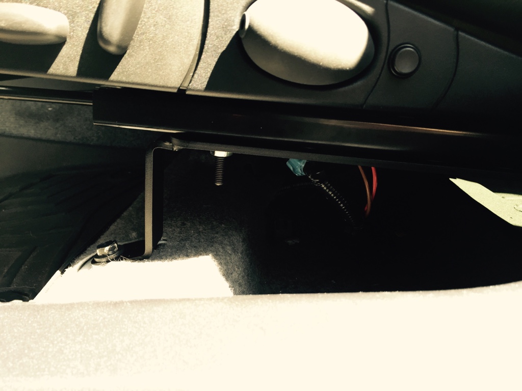

    Okay. So I ordered the planted seat bracket online, $140. I am not going to lie. It does not mate up perfectly to the stock mounting points and sits a bit too high as shown in the pictures. I would not recommend this route if I had to do it again. Also the bracket, because it binds when bolted down, does not sit completely level based on my phone compass. I am taking the seat off the bracket this weekend, and will try lowering the original base by an inch while making sure it sits level. So those interested you might want to call your local machine shop and have them fabricate one.
    Seat is the Sport Topline, vinyl with black suede option, ordered from sdtint/sdmototsports (ask for Travis) 1380 including sliders + 180 shipping from Recaro. Took 3 weeks for them to make them and deliver them to the shop

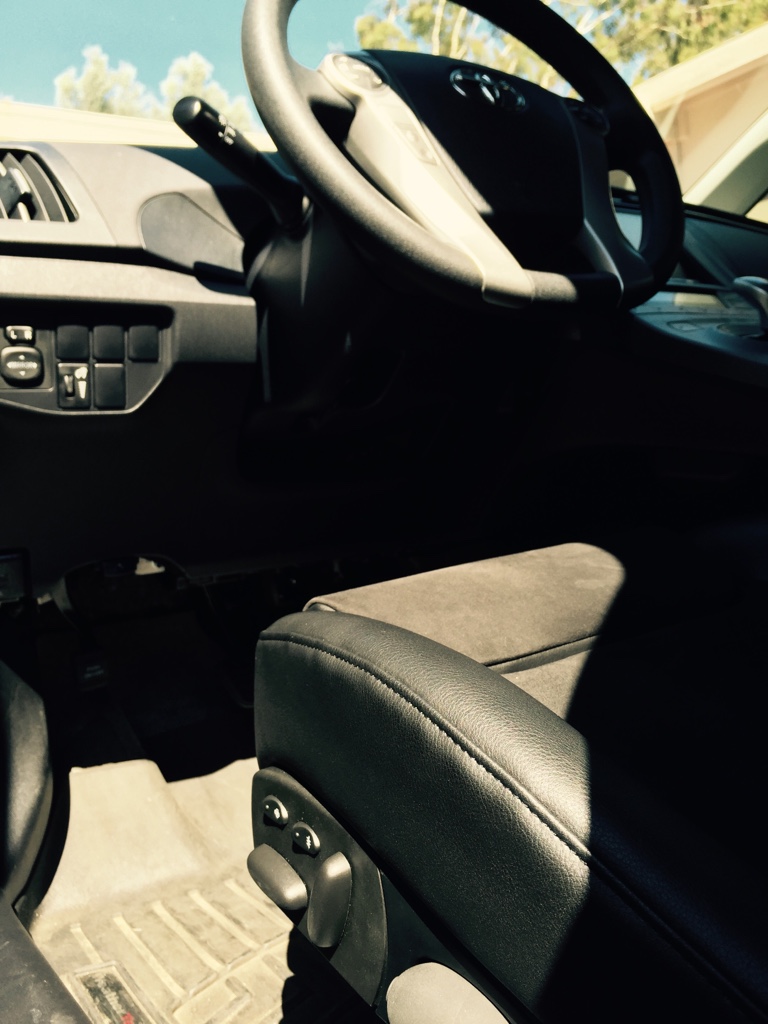

    Hope this helps. The seat sitting posture actually makes the steering wheel at the right length - so I take back what I said about the oem wheel not pulling out closer to the driver. It's the oem seats unnatural sitting position that forces you to hunch over, losing that extra few inches from your back hunching to extending.
    The seat dramatically transformed my day today. My body usually aches from stiffening my core during turns from the lack of seat support, but today I almost felt refreshed stepping out the car after a 300mile commute.
