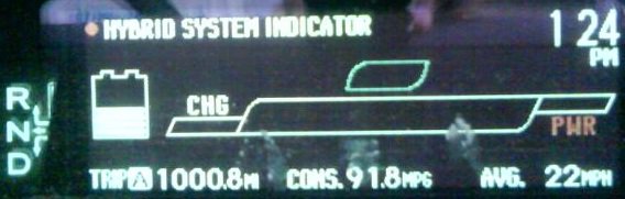

    Based upon your introduction, you should consider selling the Prius and getting a car that meets your expectations. I know our two Prius meet mine:
    A driving stunt completed July 21, 2013 burning 10.9 gallons due to a poor fill-up when I'd inverted the pump handle.
