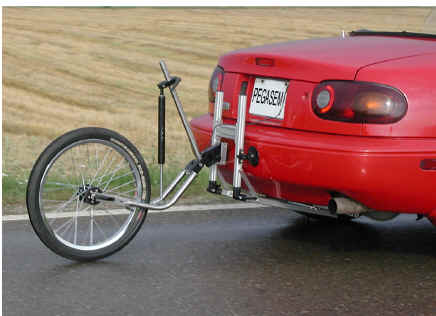

    There is a reason why real MPG metrics are done with a 5th wheel:
