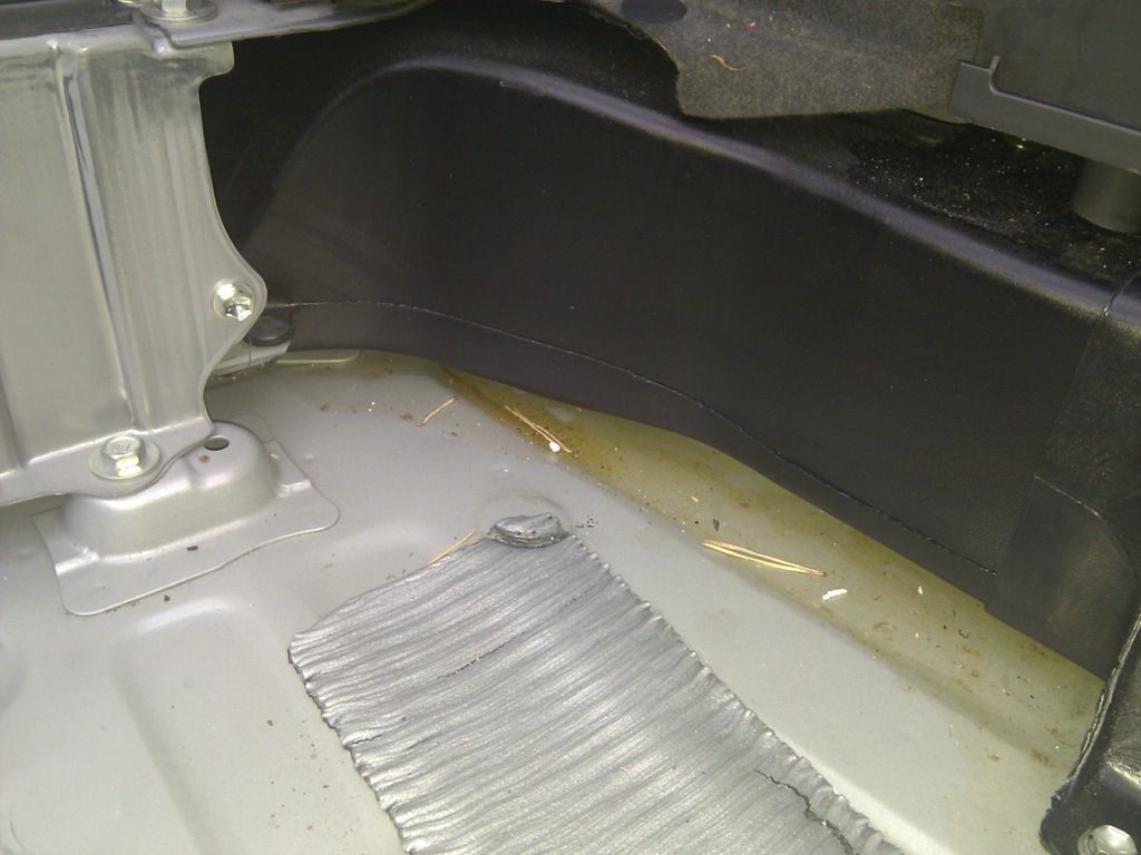

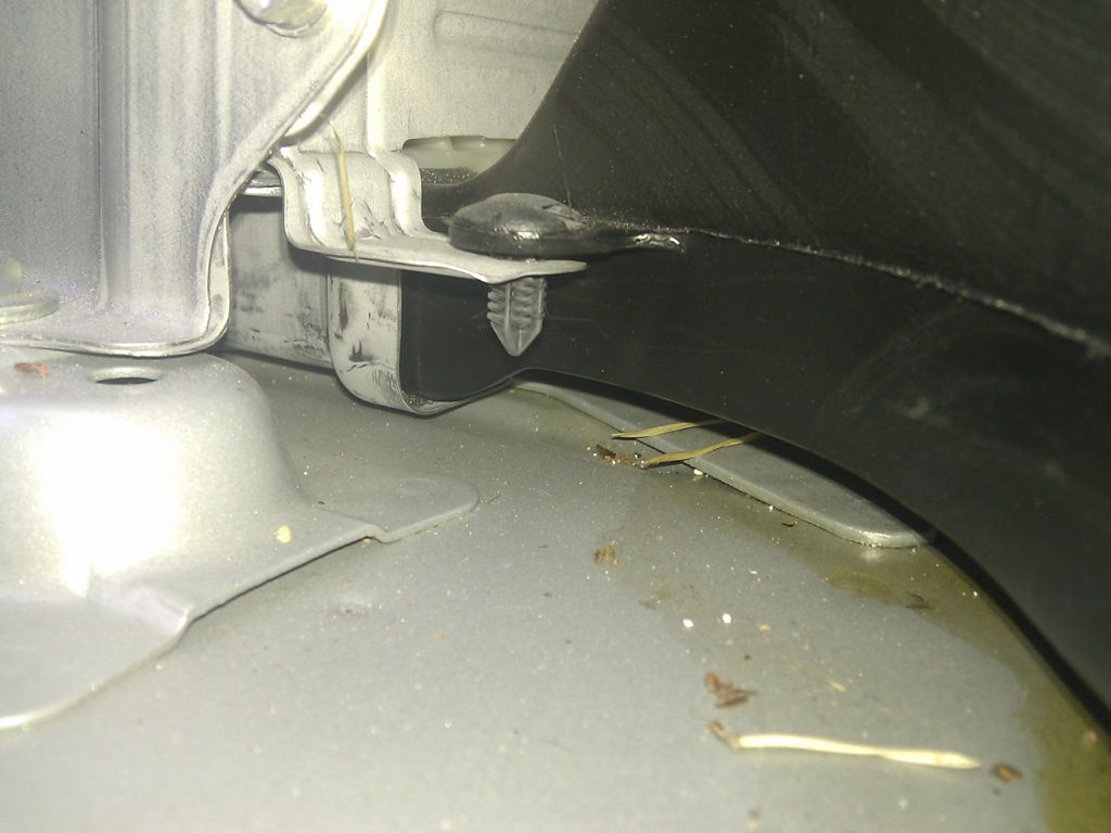

    Just bought my 2005 Prius about a month ago. I was replacing the struts today and I noticed a green foam light substance near the battery. Can anyone help me identify it and fix it?

    The battery compartment has been known to collect water when it rains. Somehow water is able to enter the Prius and end up in the battery area. So what you are seeing is most likely water that's been there for a while (moldy)...yikes

    I was afraid of corrosion or a battery leak so moldy water is actually the best thing I could imagine.

    If you have the correct battery, it should be a sealed AGM battery. It won't leak

    Nice photo....looks like that is coming from the HV hybrid batt area.
    Can't tell what the heck it is. it is near the fan vent to the rear seat, so maybe some liquid got into that vent?
    I think it might be a good idea to have fan cleaning service (many people get those cleaned out) and also if cost-effective shop available, someone could check your contacts in the HV batt and clean off the corrosion, may be see what is going on.
    The other way liquid can come is from the exit side of the vent by the rear wheel...if you got your car washed with some problem , the liquid could be forced up that black conduit and leak out there.
    OK third idea - photo almost looks like you had something (milk etc) in the rear compartment that leaked down the carpet surface and fell down over the HV batt protective structure and pooled on the floor.

    I agree with the above. In your picture it can clearly be seen that the liquid spillage was in the area above the HV battery running down and over it's top cover. Try removing the rear seat squabs, and panel over the battery to see if there is any spillage there.

    If you don't find an obvious source for that leak, the next step would be to remove the traction battery cover and make sure none of that mess came from or got into the battery case.

    Ok, got to admit I also thought it looked like spilt food too.
    Kinda looks like someone left a cake out in the rain,
    and then tried to transport it in a Prius,
    with all the sweet green icing flowing down ... :p
    Hmm, this is getting interesting now. I thought Johnny's just looked like spilled food or something, but two the same seems like a bit of a coincidence. Now all we need is one of you two to be game enough to taste it and see. :LOL:
    Ok, perhaps not taste it, but what does it smell like. Does it smell corrosive, like acid or alkali?

    The electrolyte in the HV battery is KOH "basically caustic soda used to make soap", and is colorless. It feels slippery " like soap" if you get it on your fingers not sticky. Any leak from the battery to the extent in the pictures would have dash lighting up like a Christmas tree from ground fault codes, and failing module voltages.

    KOH dries to a white powder. It is corrosive on copper and can strip paint, but is not so corrosive on steel.
