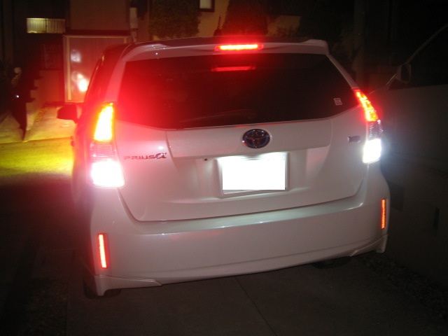

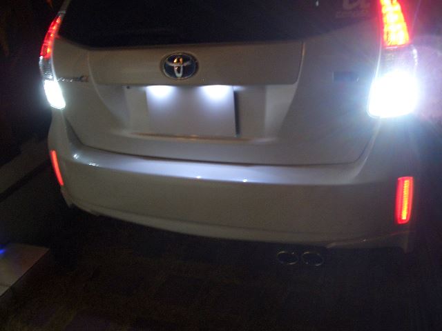

    Had been looking for LED-backed lower reflectors for less than the ebay quoted ridiculous price FOREVAH!
    And here they are, from the SHARE × STYLE (share style) shop on Rakuten, for the Prius v:
    http://item.rakuten.co.jp/share-style/ss-parts-priusa-reflector/
    SHARE STYLE | Rakuten Global Market: LED reflector lamp rear installation brief light reflector to shine for exclusive use of prius α of stop-lamp / position lamp interlocking movement 40, Toyota origin
    [​IMG][​IMG][​IMG]

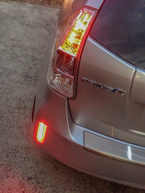

    I have it installed. A word of warning if you want to use the dual brightness function via the 2nd positive wire. By connecting the parking lights and the brake lights, it will dimly light up the centre brake lights on the roof spoiler. So for now, I've wired it up only to the parking lights to avoid lighting up the spoiler mount brake light.

    I tapped the back of the tail lights. I think because the tail light uses the same LED for parking and stop light, without a one way diode, power will always "leak" onto the centre brake light. Ideally I'd wire it up with the brake and parking lights but I wanted the car to be still legal.
    Also with some versions of these reflector lights, some come in thin wiring you can jam in the tail light plugs (what I did) or scotch-lock them if they come with thicker wiring.
    Here's mine anyway linked to the parking lights.
