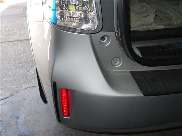

    GOT MY REAR BUMPER LIGHTS TODAY.
    I had them wired to be on only with parking and headlights - no brake or turn signal. I could have opted for one or the other.
    "Better seen than sorry."
    BTW Air Boss, the bumper lights are wired for normal and high brightness for use as brake or turning signal if wanted. Mine are set up for "normal" brightness.

    My bumper lights are wired to be on for "parking" and "headlight" only at normal brightness. I decided I didn't want them for turn or brake function.
    NOTE: I had my rear bumper lights professionally installed and the wiring was routed through an existing rubber plug (replaced with a grommet) instead of along the rear door gasket. The installer protected the wiring (outside, under the body) between bumper and trunk floor with plastic "conduit" and silicone caulk seal in the underbody area. Very neat and OEM looking and no new holes were drilled.
    ** I had the wiring run this way because it is far less vulnerable than running it along the rear door seal area.

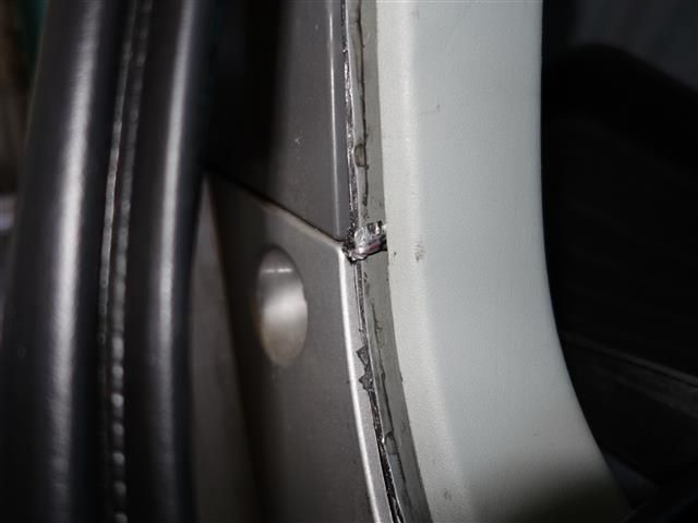

    Well that was the end of August 2014 and now March 2015 which is almost 7 months ago and I use my car daily for my business that required at least 3-4 stops with the trunk open/close, so there should be roughly over 1,200 cycles so far. And it looks like below:
    As you can see it is still working and no signs of wear or tear, thus your concern is unfounded.
    Thanks but no worry now folks.
