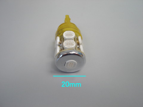

    Hi Pat. Thanks for all the pics. I haven't been on this site for awhile since I've been spending more time on 2 motorcycle forums. So far, I still have my Amber HP5's from superbrightleds installed on the front parking housing with good results. I think the warning from superbrights apply to LEDs installed on headlamp housing that may be used as DRLs...this is not recommended.
    Overall, I am very happy with what I have installed to date.

    This thread seems to fit my post more than most of the other 50 about LEDs. I do have an '08 and it has to do with LEDs, but the interior kind. I found a lot of information in my research that gave me some good ideas. I ordered my interior lights from DealExtreme and let me tell you shipping is painfully slow. I ordered my lights 10/06 and they got here just a day under 5 weeks. The install went pretty well, except I thought I could get away with a bigger LED cluster in the doors. I did with some modifications (see photo).
    Here's a list of what I bought with some notes on things I would do differently.
    Vanity Lights
    #31 1.5W T10 Car Festoon 75-Lumen White LED - Aluminum Shell (DC 12V) 2-Pack x01 $9.60
    Map Lights
    T10 1.5W 75-Lumen White LED Light Bulb for Vehicles - Aluminum Shell (DC 12V) 2-Pack x01 $7.25
    Front and Rear Interior Lights
    1.8W White 12-LED 72000mcd Cabin/Dome/Door/Glove Box Light (12V DC) x03 $20.37
    I had thought this would fit in the cargo area, major-wrong-o. I should have ordered a rectangular board, or a 5-bulb festoon. I'll need to resolve this, it's my only bulb not replaced.
    License Plate
    F102C 1.6W 36-Lumen 2x5050 SMD LED Car White Light Bulb (Pair/DC 12V) x01 $10.40
    Doors
    T10 3W 100-Lumen 9x5050 SMD LED Car White Light Bulb (2-Pack/DC 12V) x01 $7.10
    I did some modification here, but it worked out alright. I took a 1/2" drill bit and made the existing hole enough to slide the housing through.
    Overall it went smooth. 5-bulb festoons for the doors and cargo would have been much better that the ones I picked. Perhaps square or rectangular boards for the front and back interior lights would have looked just as well. Watch out for that 3M sticky side, once it's attached it's not coming loose. I would have liked to move the rear light over a half an inch, but it'll work. I will probably post some photos of the light show once it's dark.
