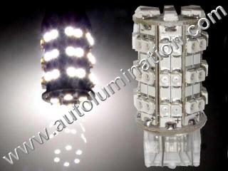

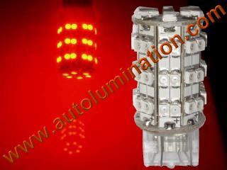

    I use these with the 7443 base for my rear lamps and back up lights. There is a 120 led version now!
    [FONT=Arial][B][SIZE=5][FONT=Arial][COLOR=#ff0000][SIZE=5][SIZE=5][SIZE=5][url="http://autolumination.com/7443_7440.htm"]Tail Light Brake Light Turn Signal LED Bulbs[/url][/SIZE][/SIZE][/SIZE][/COLOR][/FONT][/SIZE][/B][/FONT]
    68 High Powered Wide Angle SMT LEDS
    These Bulbs have Advanced Surface Mount Technology LEDS
    60 high powered SMT side facing LEDS - 8 high powered SMT forward facing LEDS
    Only 20mm diameter x 57mm overall - fits all stock housings
    $24.99 Ea.
    7440 Single Circuit 7443 Dual Circuit
    Super White
    Red
    Amber
    Choose Color
    Choose Type
    ***Click Here to add a tracking number to your order***
