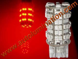

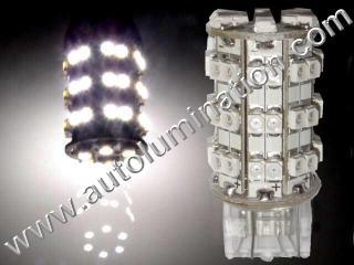

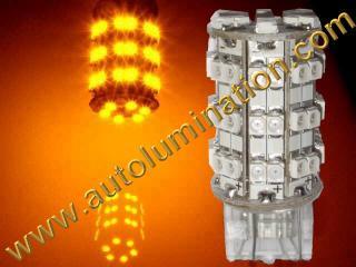

    This entire bulb fits in the reverse light housing ?

    Most LEDs are less efficient that the cree's. Most cree's are good for 100 lumens/watt (or more)
    Though a galazillion SMD leds can have wide dispersion, I don't generally recommend such bulbs if you want something
    bright, compact and efficient.
    In addition, those bulbs are grossly overpriced.
    In addition, it doesn't state what type of led is used, how much power it consumes, or how many lumens it produces.
    At least the multiple SMD LEDs I buy use 5050 LEDs, and generally state the power and lumens. Oh, they are much cheaper also.
    I can get 2 bright a$$ cree LEDs for under $15 shipped on ebay, from a variety of sources.
