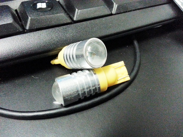

    Not trying to highjack - but following up on LED EVERYTHING... Anyone had good luck with replacing the turning blinker 7440 amber bulb with LEDs. Most amber leds are dull unless you get a pretty high wattage. Even for my parking lights I had to end up with a Cree projector style amber bulbs.
    Pictures and others experience would be awesome. (y)

    Those look like high power single LED lens'd bulbs whereas most everything I've been working with is multi SMD type. I have not really done any exterior lights aside from the license plate bulbs.
    However I have considered the exterior bulbs. These appear to be a very bright option from superbrightleds.com. Problem is they are $25 a piece :eek: . So that's $100 for all four turn signals and $150 if you include the back up lights! I don't think they will fit for the tail lamps as those have a shroud inside the housing. From the user pics they seem good enough to used as brake lamps.
