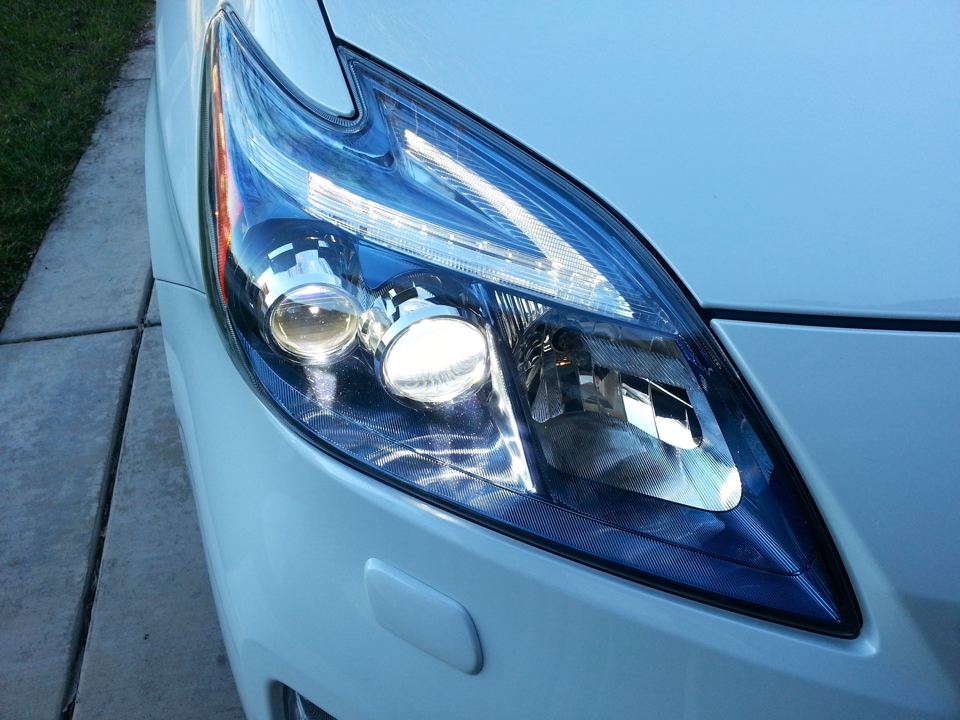

    You have the better looking 2010-11 LED headlights (y)

    I do not like the 2010-11's mismatching parking lights, but that is an easy fix with an LED bulb. The 2012s have built in V shaped parking light strips.
    I do wonder if the 3 LED setup is brighter and perhaps offer better lighting off to the side. One side effect of my two LED setup is I get flash because people think I am running high beams.

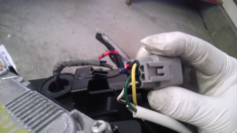

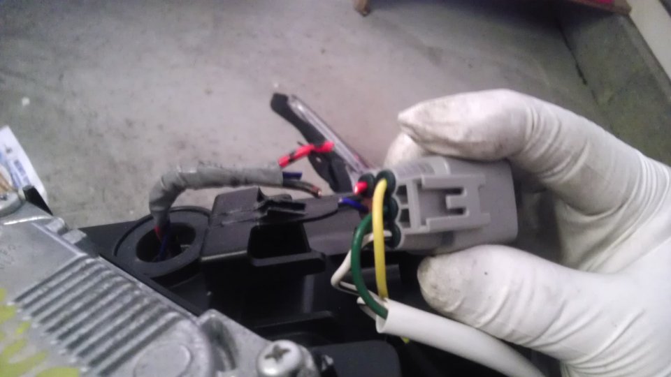

    Yeah, you would need the LED driver for both sides, it acts similar to a ballast for HID's. Here is one of them here. Search around on eBay or maybe a junkyard. I got lucky and got them for about $90/each. The module bolts onto the bottom of the headlight, and is usually sold without it. Auto-bodies typically will reuse the LED driver and just purchase new headlights. The headlight will have a 2 male cables hanging out which connects directly onto the driver.
    A harness is not needed and will add unnecessary costs. Since you have spare H11 HID kits, this will be perfect. You simply need to trace the + and - that goes into the LED driver. Cut off those two cables from the headlight, and make a harness out of your spare H11 kit. This way, your stock headlight harness is untouched. When you actually lay the parts out, the pictures I have posted will make more sense. If you take a look at the 4th picture, you can see how I converted my old HID adapter to work with the LED ballast.
    This picture attached shows you the cables you need to power on the LEDs (red + black wires) 2012-09-02 14.57.59.jpg
