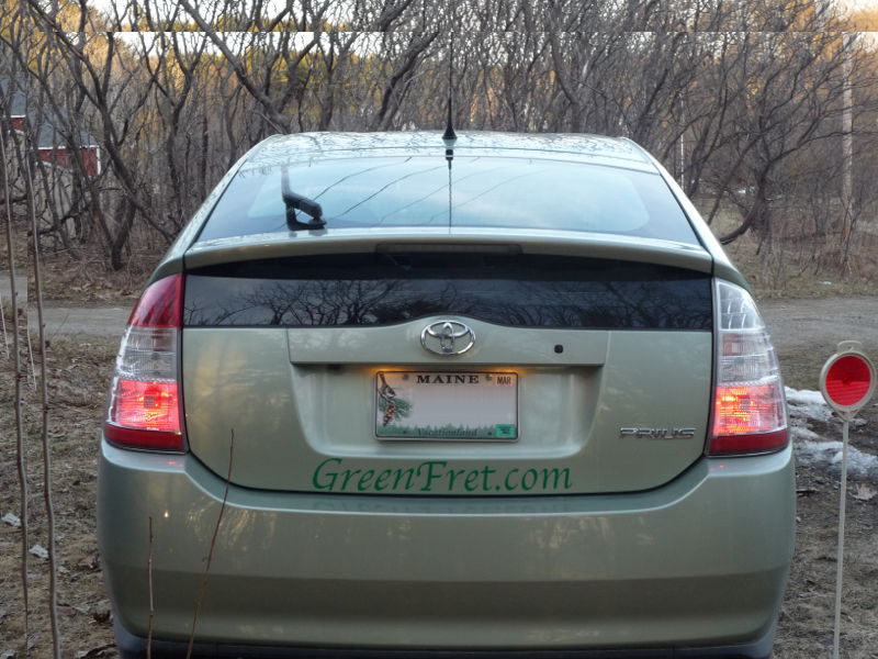

    I found a picture:[​IMG]

    And here is a picture of my car with red LED tail light on the left, and stock white bulb on the right:
    Note the tinting on the brake lights only on the left as well.

    whats with the one red brake? what are you trying to do there? the standard red LED brake is quite bright already.

    I took the picture after I had tinted one brake light but before I had tinted the other.

    As others have said... this is a mistake! Always match the LED color to the filter (lens) color! As a fun experiment to demonstrate the problem - shine an LED flashlight through a glass of red wine. Now try it with an incandescent flashlight of the same brightness (ha, if you could find one!). The difference is dramatic. Never use a white LED behind a red lens. You'll only get a small percentage of the light output as there is very little red in a white LED (blue coated with phosphor).
    Or to put this another way - the bulb you replaced was NOT white. It was, in fact, yellow/orange. There is a LOT of red in a hot wire so most of it gets through the filter. I "white" incandescent bulb and white LED have almost nothing in common.
