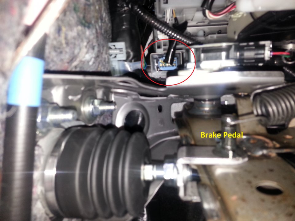

    It is up above the brake pedal high in the dash. That is the way to approach it. It is likely attached to a white plastic tray that is very hard to get out in one piece.
    I am pretty sure there was a least one 2012 owner that did that job and suspect that 2013 is similar. Keep searching and reading.

    Just like Spierman said.....its above the brake pedal high in the dash between the steering colume & the A pillar. You will have to remove the lower dash cover to get to it.

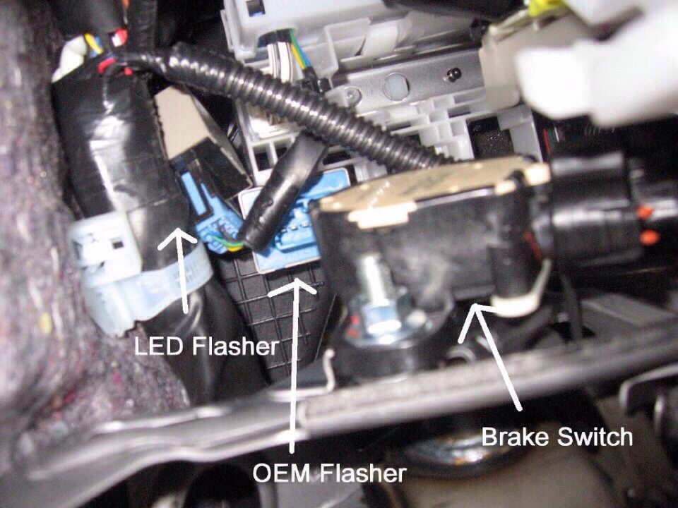

    Handparty, here is my 2013, again like spiderman said, is all the up there.
    Lay down on back, your head should near the brake pedal and reach all the way up there,
    once you feel the relay, use your finger nail & press hard to release the lock then pull down & wiggles slowly
    (not with force).
    The lock is between harness & the A-tray-like -wall.
    Good luck!

    I have a 2012 and I replaced my flasher. It wasn't easy. I found it impossible to remove the flasher itself. Using a bent coat hanger, I was able to tug on the harness while depressing the retaining clip with my finger. It took several tries, a flashlight, and some cursing.
    Then, I was able to attach the led flasher to the harness. With a bit more cursing, I was able to zip tie the led flasher to something nearby to keep it from flopping around. I have yet to replace my turn signals with LEDs as there seem to be no LEDs that are bright enough being sold.
