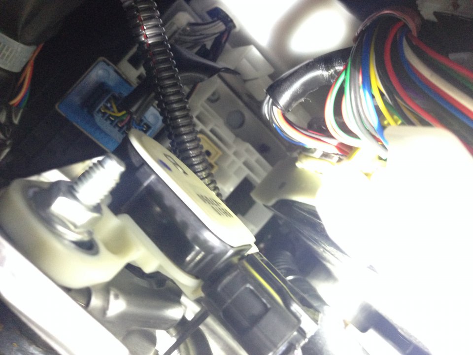

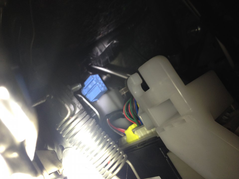

    Thanks for all the guide. It helped tremendously. Too me less than 10 min to take out the old relay and put in the new adjustable.
    Here are some pictures. Hope it helps.
    Out with the old
    In with the new and test
    Clip back to position
    It helps with my small frame. I was able to lie on the brake pedal and had easy access to the relay.
