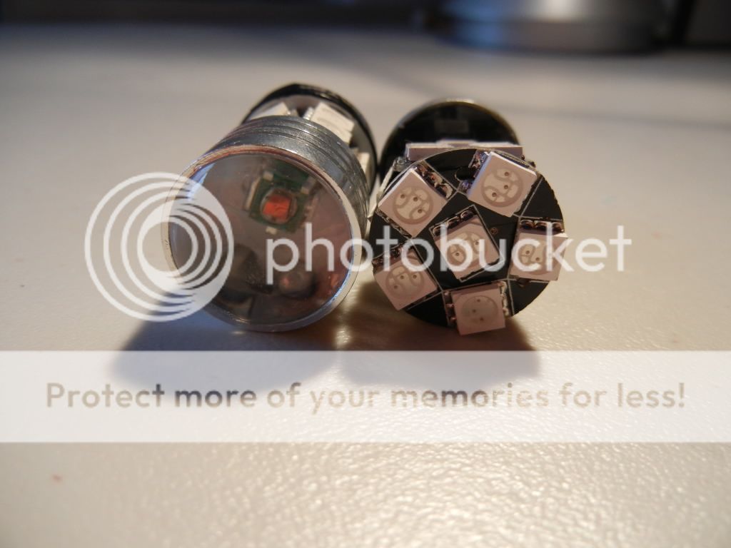

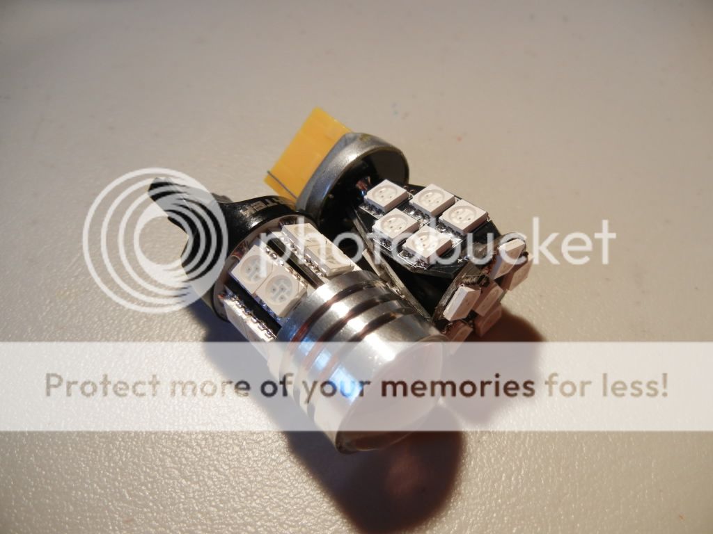

    Hi all,
    Purchased a set of LED turn signal bulbs a while back but wasn't really satisfied with the output. So I just recently got another set. The first set uses 21 - 5050 SMDs. You would think that would at least come close to the OEM incandescent bulb. But no. I have to admit though, Toyota's OEM signal bulbs are very bright.
    The new set (GP7440-CREE-12A) I purchased has 12 - 5050 SMDs with one 5W CREE unit, plus a projector lens. These are much better and are pretty close to the output of the OEM bulbs. The build quality of these are very good. There is no way they "double" the light output as they advertise but would say they make a suitable replacement for the OEM bulbs. The big test is to see what they look like when the sun is on them. I won't have an opportunity to do this for a while.
    The following are photos and some videos. Enjoy.
    LO LED video by spideyatwork - Photobucket (Low output LED)
    Incondecent video by spideyatwork - Photobucket (OEM incandescent bulbs)
    HO LED video by spideyatwork - Photobucket (High output LED)
    Hope this helps.

    I had some of those Cree 5w + 12 5050 SMD LED lights with projector lens in the H11 flavor installed in my OEM foglights used as DRLs (amber color). In the bright noon sunlight (Hawaii), they were difficult to see.
    When I took them out, the projector lens had some melting/haze on them, so the lenses must be plastic not glass. But my Crees were burning for extended periods and not used as flashers like yours will, so you should be OK in that regard.
    The other thing about those Cree LEDs with projector lenses was they were highly directional, with the brightest light thrown out at a narrow angle due to the lens. The 12 5050 SMD LEDs really didn't put out much light. So I suspect that only people directly in front of the bulbs will actually see the light output, and that they really won't see much from the sides or from a wider angle that's not covered by the 5W Cree LED.
    Edit: I just watched your vids. You can tell that the incandescent bulbs put out a lot more light than even the HO one. You can see a lot more "flare" in the camera's lens from all the light hitting the lens with the incandescent lights. You'll just have to take it out in the sun and see if the decreased brightness is acceptable to you.

    All good points. I think the color temp of your "white" bulbs were close enough the sun as to make then un-noticable. I has the same problem with my reverse LED bulbs. Amber is a little different.
    Thanks for pointing out the plastic lenes.... I didn't think to check that. Will the next time I have the out.
    Fortunately the primary viewing angle for the turn singals is head-on. Definately side throw is important but I would think the 12 SMDs should do the trick. Will find out.
    Yes, the Toy OEM bulbs are amazingly bright. If I didn't really like the LEDs, I wouldn't have replaced em.
