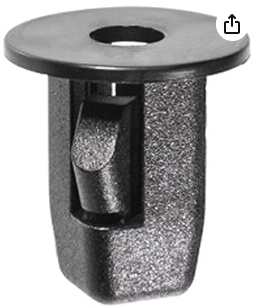

    They’re very tricky to get off, likely the “official” method to remove is to just destroy the locking jaws and replace. Anyway:
    There’s two jaws, diagonally opposite in a square pattern. I used a pin in the centre hole, trying to catch the end of a jaw, press it toward the center, while prying up on the fastener’s flange at that same zone.
    If you’re successful in releasing the jaw, the flange will stay a little raised. Keep something in the gap and repeat the process on the diagonally opposite jaw.
    it helps to be myopic, and/or use good reading glasses and good light. Still you’re mostly going by feel. I believe one of the two you can see ‘round the back, get a better understanding of how the jaws are oriented, maybe even release one of the jaws.

  4. Mendel Leisk
    61,572
    42,362

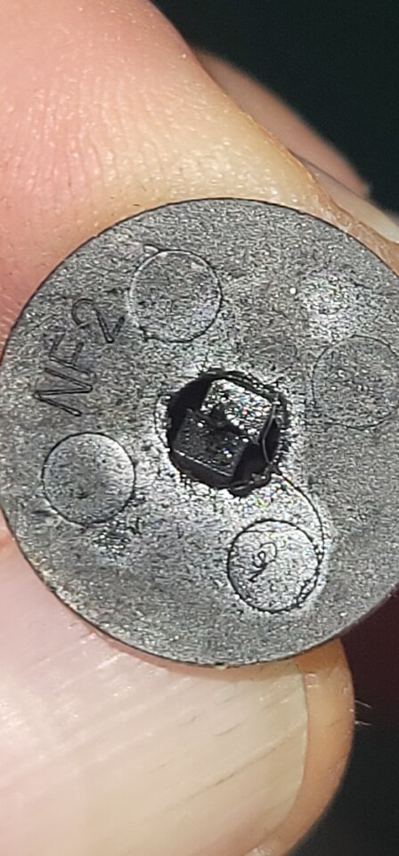

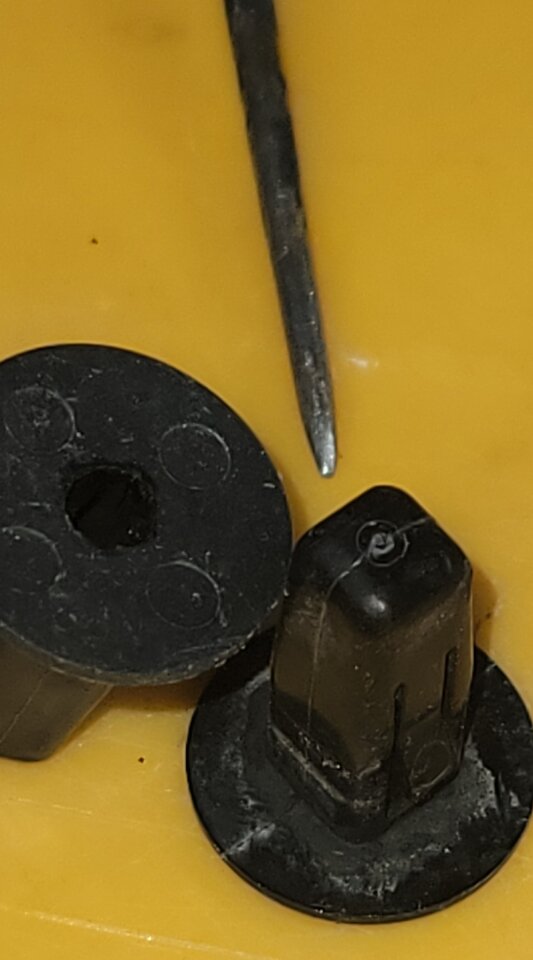

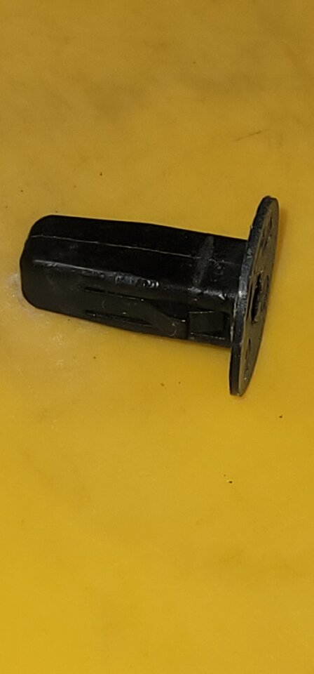

    Huh! Mine are different. But Mendel's trick worked. I used a sharp ice pick to pull one side at a time into the center hole. Not sure what part they used in mine. Here are some photos.

  7. Mendel Leisk
    61,572
    42,362
    In the left-side thumbnail, you're squeezing the jaws together with your fingers? That's basically the release trick, get something through that hole, pressed on the jaw head, push it towards the center, simultaenously prying the flange on that side. Keep that flange lifted (can take a few tries), then repeat on other side, which usually goes slghtly easier.

    Naw, just showing it. Already removed.
    Usually I could get one side to pop up by pushing in from the side, then pull in from the end...
