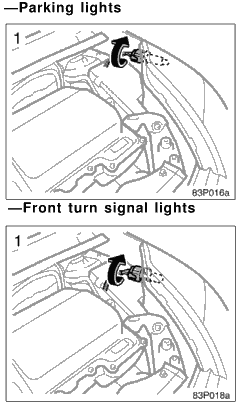

    The owners' manual sure doesn't show any fussing around with bumper covers or headlight assembly removal to swap turn signals:
    Are you sure you don't know anybody with smaller hands?
