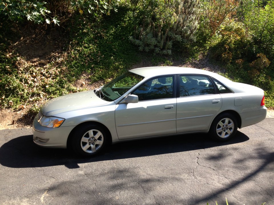

    photo (7).JPG I also have a 2001 Avalon which is a pretty sizable car with 15" wheels... looks pretty normal to me. Actually, the 15" OEM tires have a slightly larger outside diameter that the 17" tires on my Persona.
