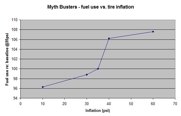

    • I don't think that the Mythbusters did a very good job. If you plot their data (see attached), there's obviously something wrong with the 40psi data point. It looks like they did short trips, didn't check wheel alignment, didn't allow tires to come back to ambient temperature after every inflation change and run, skipped over certain inflation pressures, used a human driver, etc. Mythbusters are primarily entertainers.
    • I also don't think that the Prius is the best test bed for determining rolling resistance. For a short trip, some of the energy used during that trip could have been derived from the burning of gasoline before the trip even started! One would have to do a lot of absolutely identical trips, with constant temperature, wind, etc. and would have to make sure that the state of charge was identical at the beginning and end of each trip --- if this is even possible. But, with enough driving some trend might be noticeable.
    • I still believe that the NHTSA tests, done in a laboratory on a large test roller are the best indicator of the effect of inflation on fuel economy. They estimated a 0.3% MPG increase for each psi. This could obviously vary by vehicle and tire -- others have estimated as much as 0.6%. Interestingly, if you throw away the "bad" data point in the Mythbuster's data you also get about 0.3% per psi.
    • Finally, I don't think there's anyone who thinks that increasing inflation pressure doesn't increase MPG. It's only an issue of how much and whether you like the change in the ride characteristic.

    Your chart shows a baseline of 35 PSI with the the biggest differential increase @ the 42 PSI mark (y)
