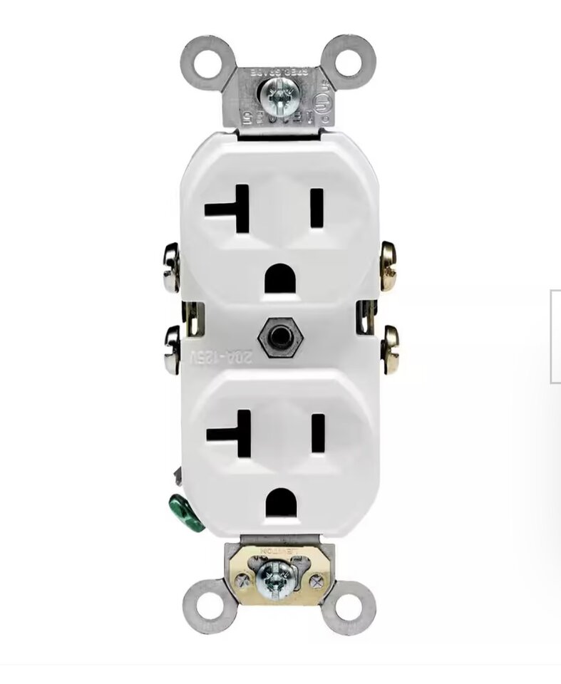

    A 15 amp circuit is legal with 14 awg romex while a 20 amp circuit needs 12 awg wiring.
    A 20 amp receptacle has the horizontal portion in the neutral socket as shown above. Some tools and appliances that run at 16-20 amps have that horizontal neutral on their plug to avoid use in a 15 amp circuit.
    With the 20 amp receptacle on a 15 amp circuit you can overload the 14 awg wire. Unlike conventional wisdom, that 15 amp breaker (standard or gfci or arc fault) won't trip for hours if at all. While people get away with this because of conservative engineering, by code it is wrong.

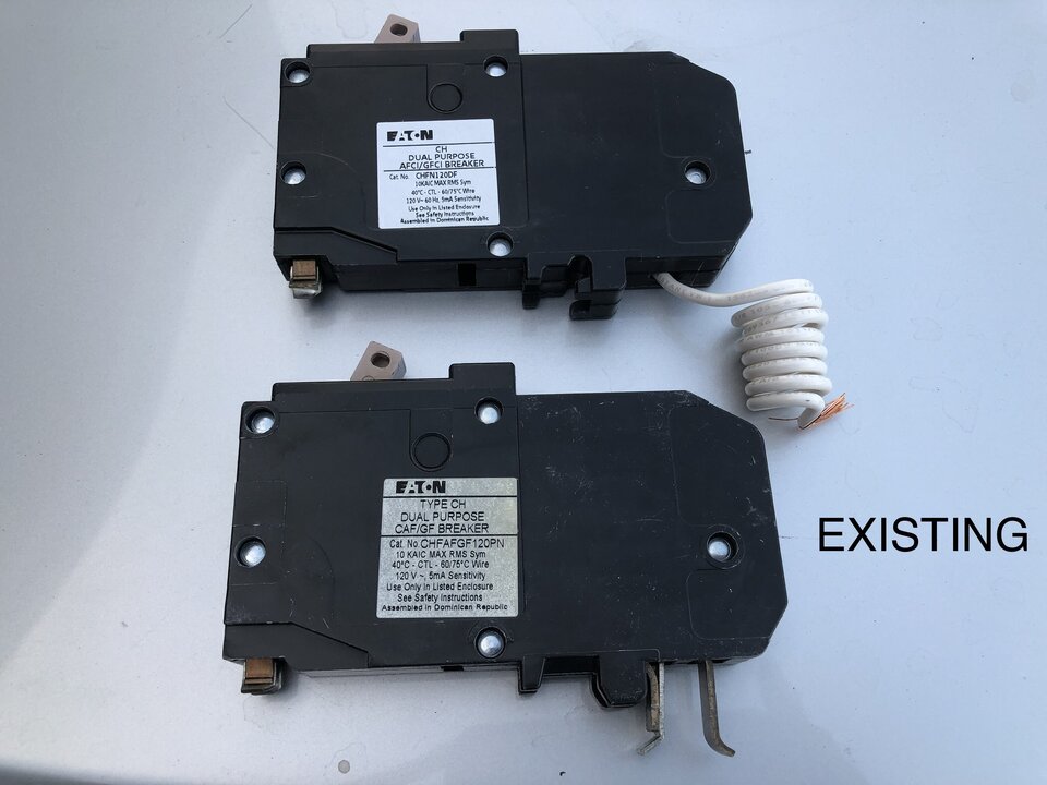

    On a side note, more recent codes require arc fault breakers on almost all new home 120 vac circuits. Typically all 120 vac circuits then get combo gfci arc fault breakers. The arc fault features address a real fire safety issue, arcs caused by loose connections or damaged wiring.
    The logic in an arc fault breaker is complex and some manufacturers like Eaton initially got it wrong including the bottom model:
    The bottom device was one of the failing gfci arc fault breakers that was used in a box with a plug in neutral bar. They would fail by false tripping and usually would trip again after resetting. They also ran hot to the touch even before failing.

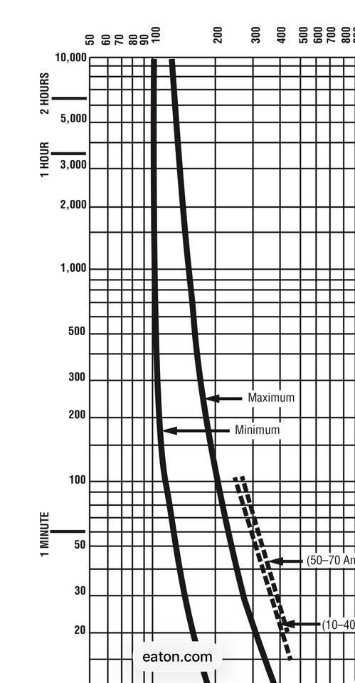

    Yes a circuit breaker has two tripping mechanisms, one magnetic that is designed to quickly trip on very high currents and one thermal which is slow but could take hours or forever at a few amps over its rating.
    For example an Eaton 15 amp breaker is 20% overloaded at 18 amps. On this thermal trip time chart that overload is represented as 120 on the horiz axis with the minimum and maximum manufacturing variances graphed. 18 amps on a 15 amp breaker could easily take 10,000 seconds to trip or realistically might never trip. A 50 amp breaker might allow 60 amps in a similar manner.
    Again, all of the codes, wiring and devices have safety factors built in so in reality it does not matter that a 15 amp breaker might not trip at 18 amps.
