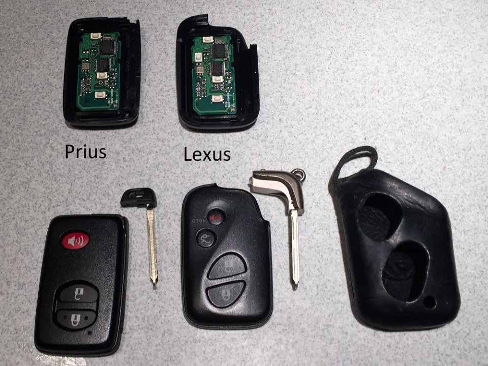

    I tried searching but I am wondering if the CT200H Key is able to be used for my 2012 Prius. They 3 button shell looks the same. I think I can just transfer the inside board into the lexus key and have the key cut by a locksmith. Anyone else do this?

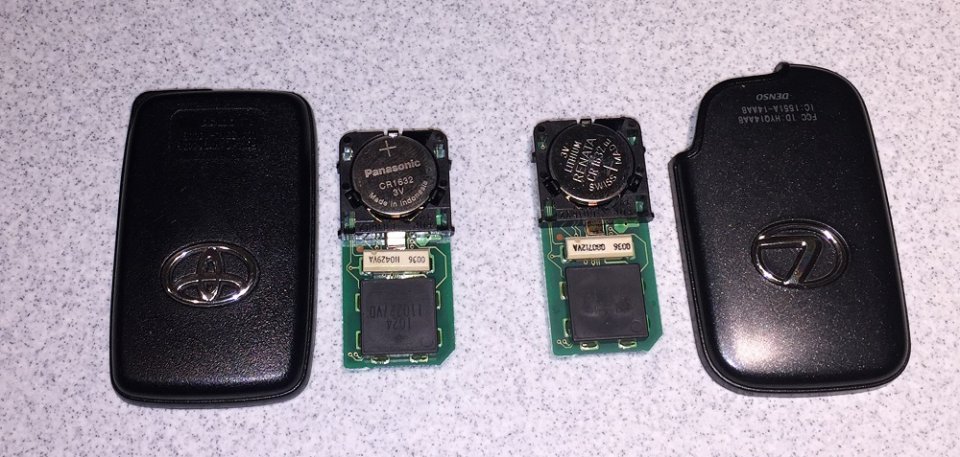

    The answer is YES that Lexus shell works on a Prius.
    My used one that I programmed for my Prius came with a leather cover. (That program mod is in another post.)

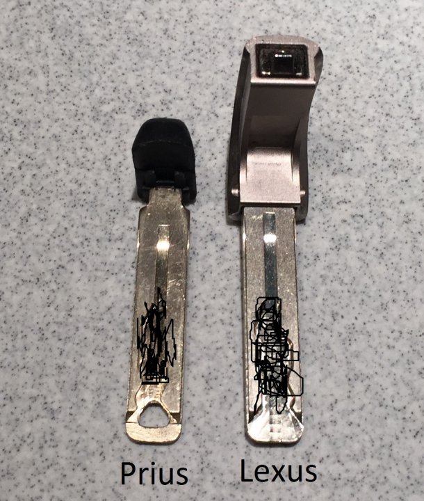

    The key is not exact (see picture) so that requires more research.
    My Lexus case has a trunk release button that is not usable if you switch the Prius into it, so the button floats with no click. I just tried it.
    Also the LED lights up in the Lexus case no problem when you hit a button on the Prius electronics inside.
