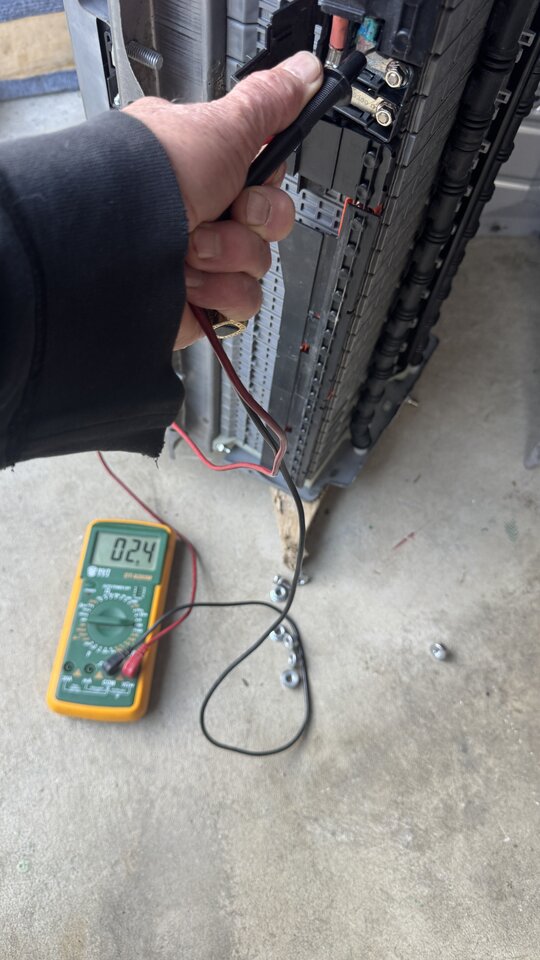

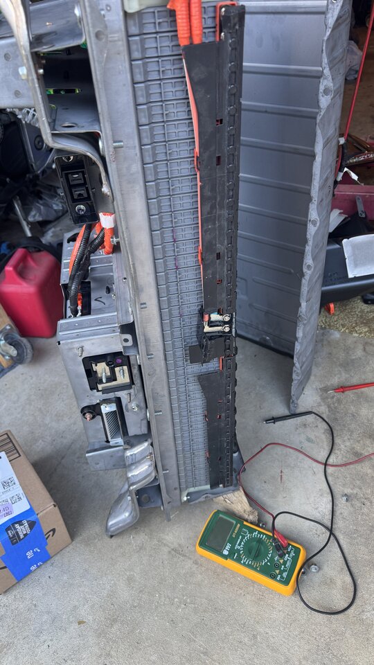

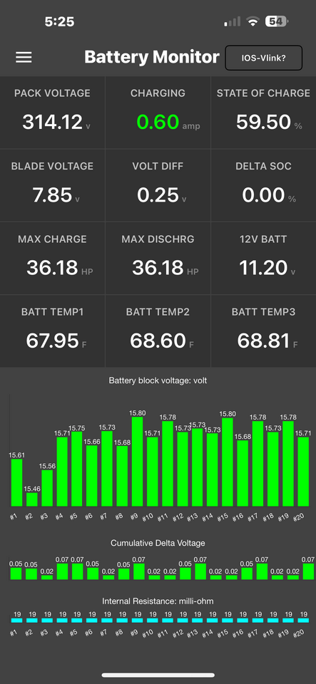

    I have just installed 40 new blades in my GS450H. Pack looks good according to diagnostic (photo) but getting error code P0A0D. Safety plug was correctly installed but there is almost no voltage at the port.
    I have discovered there is almost no voltage at the battery terminals the safety port is attached to (photo). When I test these terminals independently they show 150V and 165V respectively. What could be wrong?

    There is nothing wrong with the hybrid battery. You are only seeing 2.4v on the meter because of where the positive and negative probes of the meter are connected to. Think about what you are measuring across those two terminals.

    To answer all the fuse in the safety plug is ok and handle slide locked after insertion. The voltage on my old pack was a red herring. Probably due to shorts in old batteries. I swapped the wiring from the old pack except those connected to blade terminals. Now the vehicle runs and drives but shows battery code P0AFA, low voltage. Monitor shows both modules 8 and 9 pulsing from over 15V to 0V. Vendor is sending me new blades but I’m not sure that’s the answer. Thanks everyone for your responses.
    This is actually Block 8 and 9, which is 4 modules total, right?
    The good news is "pulsing from over 15V to 0V" is physically impossible for a block/module to do for real, and is only an indicated value that is flip flopping. As mentioned, most likely due to failing connections in the wiring harness or ecu/ecu socket.
