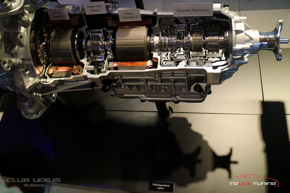

  13. Yamamoto2
    Yamamoto2 Junior Member

    Cutaway of LC500h transaxle.

  14. Yamamoto2
    Aug 23, 2011
    Moscow, Russia
    Two planetary gearsets and 4 clutches (except PSD).
    MG2 with hairpin windings.
  15. GasperG
    GasperG Senior Member
    May 13, 2011
    1,168
    598
    Slovenia
    2018 Prius
    Where do you see clutches? May someone correct me if I'm wrong but this thing should work without any clutch, the PSD (together with MGs) system can work like a torque converter.
    Actually this is a perfect torque converter with minimal losses, it doesn't need torque converter lock-up (or is it there?)

  17. GasperG
    May 13, 2011
    1,168
    598
    Slovenia
    2018 Prius
    I thought a normal clutch like in function of decoupling engine from the wheels - there is none.
    Clutches and brakes on the picture must be there in order to change gear ratios, like in every other AT.
  18. Jeff N
    Jeff N The answer is 0042
    Oct 23, 2010
    2,382
    1,304
    California, USA
    2011 Chevy Volt
    I'm looking forward to reading a real engineering paper on this new design but from what I've seen so far it appears to conceptually be a typical Toyota hybrid transaxle with a final gear ratio that is shiftable among 4 different choices via an automatic transmission instead of having a fixed final gear ratio before the differential gear like in a Prius.
    The changeable final gear ratio allows them to optimize the HSD motor usage and rpm speeds. With only a fixed final gear ratio, the HSD design has to be compromised and balanced between launch acceleration, efficiency, and vehicle speed limitations. Adding 4 possible final gear ratios removes some of those needed compromised but takes up more physical transmission space, adds cost and complexity, and adds additional mechanical friction losses. Toyota describes this system as having 8 gears so perhaps they have reprogrammed the HSD behavior to mimic fixed gear shifting because they think drivers in this vehicle class want that.
    BMW did something similar with their car that briefly used GM-derived Two-Mode hybrid transmissions a few years ago. The new CT6 hybrid design use a 3rd planetary gear set and extra clutches integrated within the power-split design to achieve 3 fixed gears and apparently 3 e-CVT modes with the gas engine running that accomplish some similar goals as the LC500h design. But at the end of the day, these cars go faster because they have bigger gas engines....
    The Lexus has a modestly higher engine output, weighs 400 pounds less, and claims 0-62 in under 5 seconds. The CT6 hybrid claims 0-60 in 5.6 seconds but has a rechargeable battery that gives 37 miles of EV range. I haven't yet compared vehicle size or interior dimensions. I'm curious to see the final EPA hybrid mpg ratings.

  19. Trollbait
    Trollbait It's a D&D thing
    Feb 7, 2006
    22,043
    11,511
    eastern Pennsylvania
    They still have the wear and potential failure of the clutch you thought that made not having them in the HSD a Good Thing.
