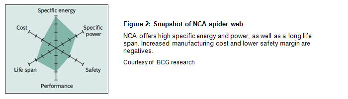

    Lithium ion batteries come in many variations and Tesla chose the high-energy nickel cobalt aluminum chemistry (NCA) for the S-Model. Made by Panasonic, the cell is rated at 3,100mAh, a specific energy that is slightly higher than most contenders. Other advantages of the NCA are high specific power for exuberant acceleration and long life. The negatives are high cost and a lower safety margin than other Li-ion systems. Figure 2 outlines six of the most important characteristics of a battery in a spider web.

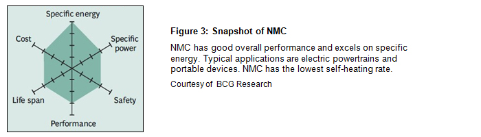

    Batteries for the electric powertrain need high loading and a long life, and the NMC is another popular Li-ion system. NMC stands for nickel-manganese-cobalt and is also used in e-bikes, power tools and military and medical devices. The cathode may consist of one-third nickel, one-third manganese and one-third cobalt, but other combinations are also used to satisfy special requirements. These blends lower the raw material cost due to reduced cobalt content. Figure 3 demonstrates the characteristics of the NMC.

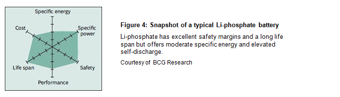

    Another popular Li-ion system for electric powertrains is the Lithium Iron Phosphate (LiFePO4). Its strength lays in long life and superior safety, but it has a lower capacity than cobalt-based Li-ion systems. A further tradeoff is the lower nominal voltage of 3.3V/cell rather than the customary 3.6V/cell of other Li-ion systems. Figure 4 summarizes the attributes of Li-phosphate.
