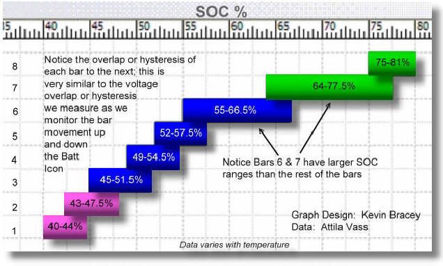

    SOC % is from Torque app. Target SOC in HV mode is 6 bars (23%). It may swing lower or higher depending on driving condition.
    Also, the bars are not linear. This is from a regular Prius NiMH battery with smaller battery.
