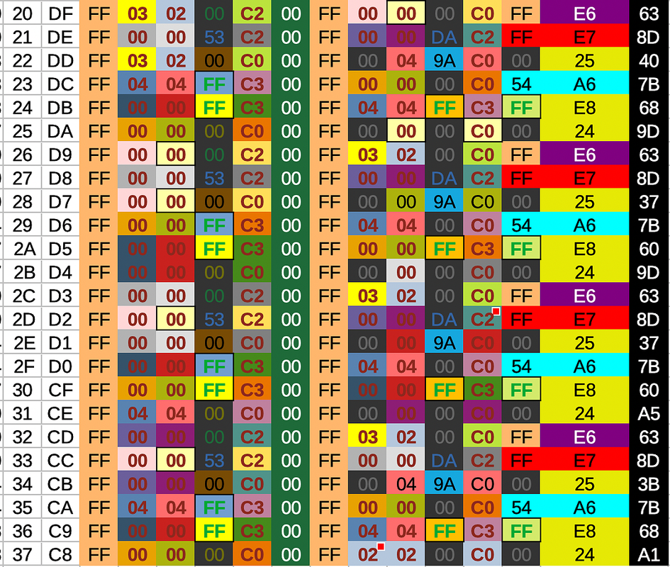

    FYI: Here's a color-coded preview of the Gen3's serial protocol:
    ...it's a little more complicated than the Honda Insight's BATTSCI frames, but still not too difficult to figure out if you know what you're doing. Fun problem to reverse engineer. For reference, the Honda system packs all this data into 16x fewer bytes (24 vs. 384). Not saying Toyota's method is bad... just very verbose.
    I'm still trying to figure out what a couple bytes do, but the other QTY382 are fully deciphered. I believe one of the two unknown bytes is actually an error in Toyota's official serial data stream (0x37B10 is always identical to 0x37B11). For now I intend to just duplicate the as-found behavior, although for academic purposes I'd like to figure that out eventually.
    Overall I think Toyota made some odd design decisions on the BSU. I prefer Honda's system of having separate battery and motor control computers (BCM & MCM, respectively). Toyota does things differently, which means the BSU ends up passing a bunch of pack-specific information to the main computer. It's less modular, but obviously it works.

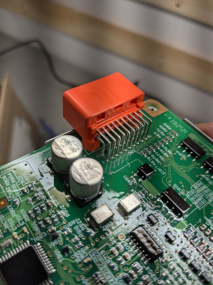

    Just finished the LiBSU proof of concept:
    This project is finally in full swing!
    Excited to start the RevA schematic tomorrow!
