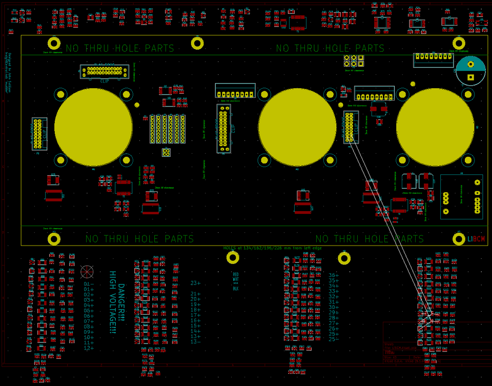

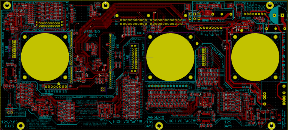

    Almost done with the schematic... starting my weekend now, but I'll be back at it when I get back. So far I've reduced the BOM cost by ~90%. I'm revisiting every existing part (from my low volume Honda Insight project). It's amazing how much you can reduce cost if that's a design goal (which wasn't the case with my existing BMS hobby product).
    For example:
    -switched from a $17.50 MCU on the proof of concept to a better in every way $0.75 MCU for RevA PCB. I'm not thrilled about the 0.5 mm TQFP pin spacing, but that's standard on modern MCUs at the density required for LiBSU.
    -switched from a $4.30 Cadillac LT RS485 PHY to a $0.35 equivalent that will work just fine in this low speed application.
    -saved $5 by downsizing the HVDCDC converter, since LiBSU will pull much less current.
    -reduced bypass capacitor QTY where appropriate.
    -added new PNs for same-valued low voltage DC capacitors ($), versus using just one HVDC part ($$$) for both HVDC & DC. HVDC caps are 20x more expensive.
    -etc.
    All these cost savings are passed onto the customer. I can see a path where LiBSU's MSRP is under $300 in QTY.
    Other notes:
    I'm trying to design the PCB such that I can submerge the entire assembly into a conformal coating, versus having to manually apply with brush (time consuming). This requires placing all connectors higher on the board than all SMT components (so the SMT pins and traces are all coated). Conformal coating is required IMO for this application.
    I'm ditching the OEM temperature sensor harness entirely. LiBSU has a single air intake temp sensor input. All pack temperatures will be located on remote BMS PCBs, and read via serial.
    LiBSU has the following onboard serial interfaces:
    -isoSPI (it will have two separate buses, assuming they both fit, TBD)
    -CAN
    -RS485 (to communicate with hybrid computer)
    -USB
    In addition, LiBSU will have either QTY2 or QTY3 expansion port headers (e.g. for grid charger option, heater option, etc). Each port has a 2x5 shrouded header, which will accept 10p ribbon cables for each accessory. Space is the deciding factor for how many make it onto the board. Each port can simultaneously access the following signals (i.e. they are unique to each port):
    -USART, and;
    -buffered SPI, and;
    -switched 5V power source (to save power), and;
    -device identifier (so LiBSU knows what's plugged into each port, if anything), and;
    -hardware PWM timer, and;
    -QTY2 analog inputs (12b ADC), and;
    -hardware interrupt.
    That's a LOT of GPIO! I wish my Honda Insight product had even half this expansion capability.
    Related: I'm using every single MCU pin (because why not?).
    #51 mudder, Nov 6, 2025

    So eventually everything needs to fit inside the yellow border...
    I think everything will fit, even though I'm using relatively large 0805 parts.
    The stamped OEM metal enclosure has some annoying contours.
    For reference, here's what my Honda Insight layout looked like on day 1:
    ...and here's what the finished RevA looked like:
    mjoo, Ivoh95, Mr. F and 1 other person like this.
