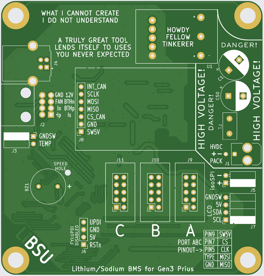

    Daily PCB layout update:
    Notes:
    -HVDC section 100% placed.
    -Connectors 100% placed.
    -Should have all remaining parts placed tomorrow.
    -Almost certainly a 2 layer board... almost every signal routes on bottom layer.
    -Planning to order PCB Monday.

    Should have the board finished later today:

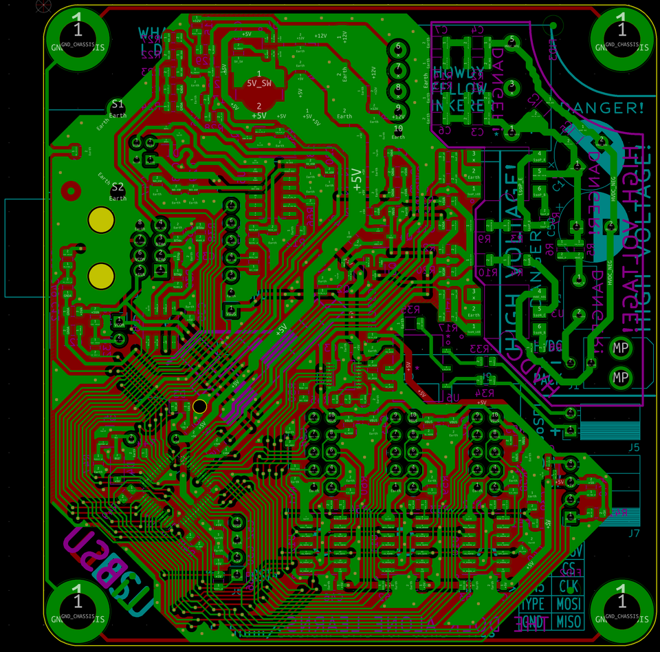

    PCB is finished. Happy to route it on just two layers:
    I'll order it tomorrow morning, after giving it one final look over.
    FYI: I ended up axing the backup isoSPI port (which isn't required for safety). There wasn't enough room on the board, and also there wasn't enough room for the second 2p connector.

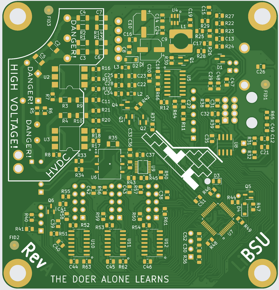

    Was up late talking with a supplier... just ordered PCB now:

    Uneventful hardware build. All the ports line up where they should (which was my biggest concern).
    My only footprint issue was accidentally ordering 249k resistors with 0805 footprint; will replace with correct 1206 part on next build.
    Maybe this RevA will ship? Too soon to tell... still need to test all the functionality.

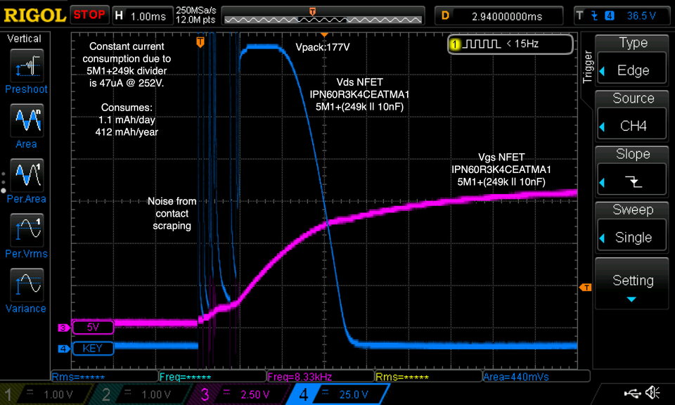

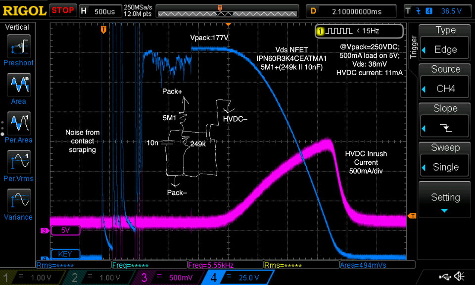

    I decided I don't like LiBSU's existing HVDC inrush current limiting circuit. Inserting the service disconnect causes a brief 5 amp spike, which slightly exceeds the onboard fuse's i2t limit. Even though most people aren't going to be installing the service disconnect plug often enough for this to become an issue, I want to make sure people who do it often don't end up blowing out the fuse prematurely.
    Option 1 is an NFET whose gate is RC LPFd to limit HVDC ramp to 10 V/ms or so. This will add a constant ~10 mW load to the pack, which is roughly 1% SoC consumed every two months. You could mirror the circuit and use a PFET if desired. I prefer NFETs because electrons are better than holes. This option requires a board spin.
    Option 2 is a higher resistance inline NTC to limit inrush current. However, LiBSU pulls so little power from the HVDC bus (17 mA max) that the NTC will never warm up... so then a 200 ohm NTC will consume ~58 mW when LiBSU is actually running. This option doesn't require a board spin.
    The tradeoff between these two options is whether to ALWAYS pull 10 mW from the pack, or SOMETIMES pull 58 mW from the pack.
    One might wonder why not just use inline resistors to limit inrush current (e.g. 200 ohms)? The answer is that NTC ICL's can handle the inrush energy much better than resistors. The moment you connect the service disconnect, whatever current limiting element is used has to briefly survive the full pack voltage across it until the HVDC input capacitors are charged. With 20 uF input capacitance, the HVDC inrush current limit circuit has to transfer ~650 mJ in a few dozen milliseconds without exploding. A fixed 200 ohm inline resistor must briefly handle 310 watts!
    #75 mudder, Dec 4, 2025

    Parts for previously proposed circuits arrived today. Results below for anyone curious.
    Pros: supplies a nice smooth ramp that limits inrush current to 1.5 amps peak. No additional power loss proportional to load.
    Cons: Constant power draw consumes ~8% SoC/year.
    Pros: Power consumption is only proportional to input current; no standby power loss. Peak current limited to ~2.0 amps.
    Cons: Power loss strongly proportional to input current; less efficient at high load current.
    After gathering this data, I'm going with Option 2. If the footprints fit, I'll add both options to the circuit board (and only populate option 2).
