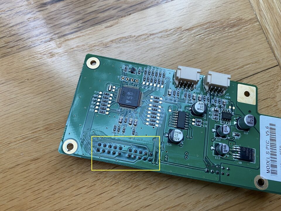

    Sorry I wasn't very clear. The sharp corners I tested were top corners of larger and taller surface mounted capacitors : 1206. On Tesla MS, a pair of 1206s were located near condensation formation and corrode. Spent extra time studying how to cover them with conformal coating and discovered the top 4 corners remains exposed (continuity on VOM) after every layer of conformal coating I brushed on (and dried). The drying process seems to just pull the thin coating of conformal away from these shape corners.
    I found this on most of the "taller" components. On relatively flat components, thickness of conformal coating smoothly transition from top of components to the board and cover the corners.
    Anyhow, if you have taller components like 1206, might check their corners with VOM.

    I also used MG Chem 419D from Amazon but didn't clean the board. Also attached pic of the MS board and its conformal appears to be sprayed on. Exposed corners were on nearly all tall components (vertical bank of capacitors in the middle of the board within yellow rectangle in pic) with MS's original factory conformal and my hand brushed on 419D. All sharp edge connector leg ends also exposed (also in yellow rectangle) I guess sprayed on conformal also don't catch around the tiny sharp tip with tiny surface area.
    I also saw the exact same exposed sharp connector ends on the MS cabin PTC heater board with factory conformal and hand applied MG 419D conformal coating.

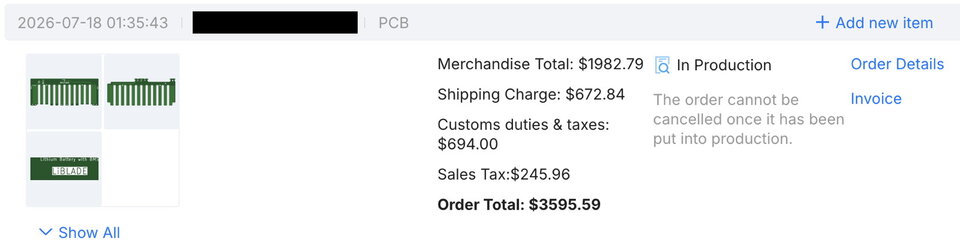

    You know that feeling when you pay extra to rush order a PCB and everything looks fine on the manufacturer's status window, whose summary is "In Production":
    ...but then you click the "Show All" button and it turns out that even though they should have shipped by now, they still haven't even actually started production yet five entire days later?:
    And the manufacturer swears they sent an email, but you ripped your inbox apart and still haven't found it?
    And now they aren't going to arrive in time for an assembly demo presentation you're giving next week?
    ...yeah, that's me right now.
    Bummer. Time for plan B, whatever that is. It's only a minor speed bump, but still super annoying.

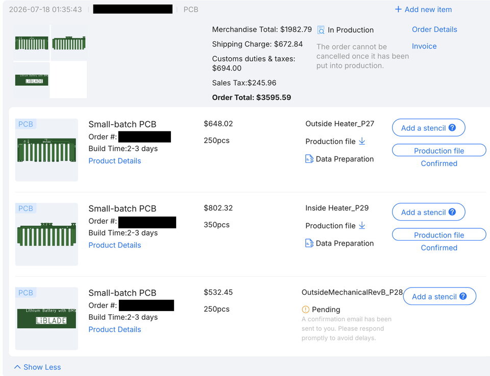

    I didn't name them in my previous post, but JLCPCB somehow managed to screw up both orders I placed for alpha build PCBs!
    Holy incompetence!
    Summary:
    -I placed a 24 hour rush order on JUL21.
    -Order should have shipped out JUL22, but didn't due to a "manufacturing defect on one PCB".
    -Rather than contact me and ask "hey mudder, do you want QTYn-1 PCBs now or QTYn PCBs later", JLCPCB threw first batch away and made a new batch.
    -No worries, plenty of time... I don't need these until JUL29.
    -Surely JLCPCB will make the replacement PCBs in the same 24 hour window and ship them JUL23? Right? RIGHT?
    -JUL23 @ 6AM "arrived at shipping center".
    -JUL25 @ 2AM "ready to pack".
    -JUL27 "(still) ready to pack".
    -These 24 hour rush PCBs should have arrived today at the latest. And yet, they're still sitting in the factory in China.
    And what does JLCPCB tell me just now:
    No. No, I do not accept $8 as compensation seven days after placing a 24 hour rush order that STILL hasn't shipped.
    I have two primary complaints:
    1: Even if a defect occurred on the original PCBs, the replacement PCBs should have shipped at most one day later (2026JUL23).
    2: As soon as JLCPCB identified the defect, JLCPCB should have contacted me and asked whether I wanted QTYn-1 PCBs now or QTYn PCBs later. Both times this happened in the past, JLCPCB sent me the good PCBs right away AND offered a partial refund.
    Cool, so now for my demo build on JUL31, I'm literally going to visit my business partner with all the parts required to assemble QTY15 packs... except that I'm not going to have any PCBs so what am I going to attach all those parts to? Maybe I'll hot glue them together?
    Thanks JLCPCB for failing to deliver! Twice!
