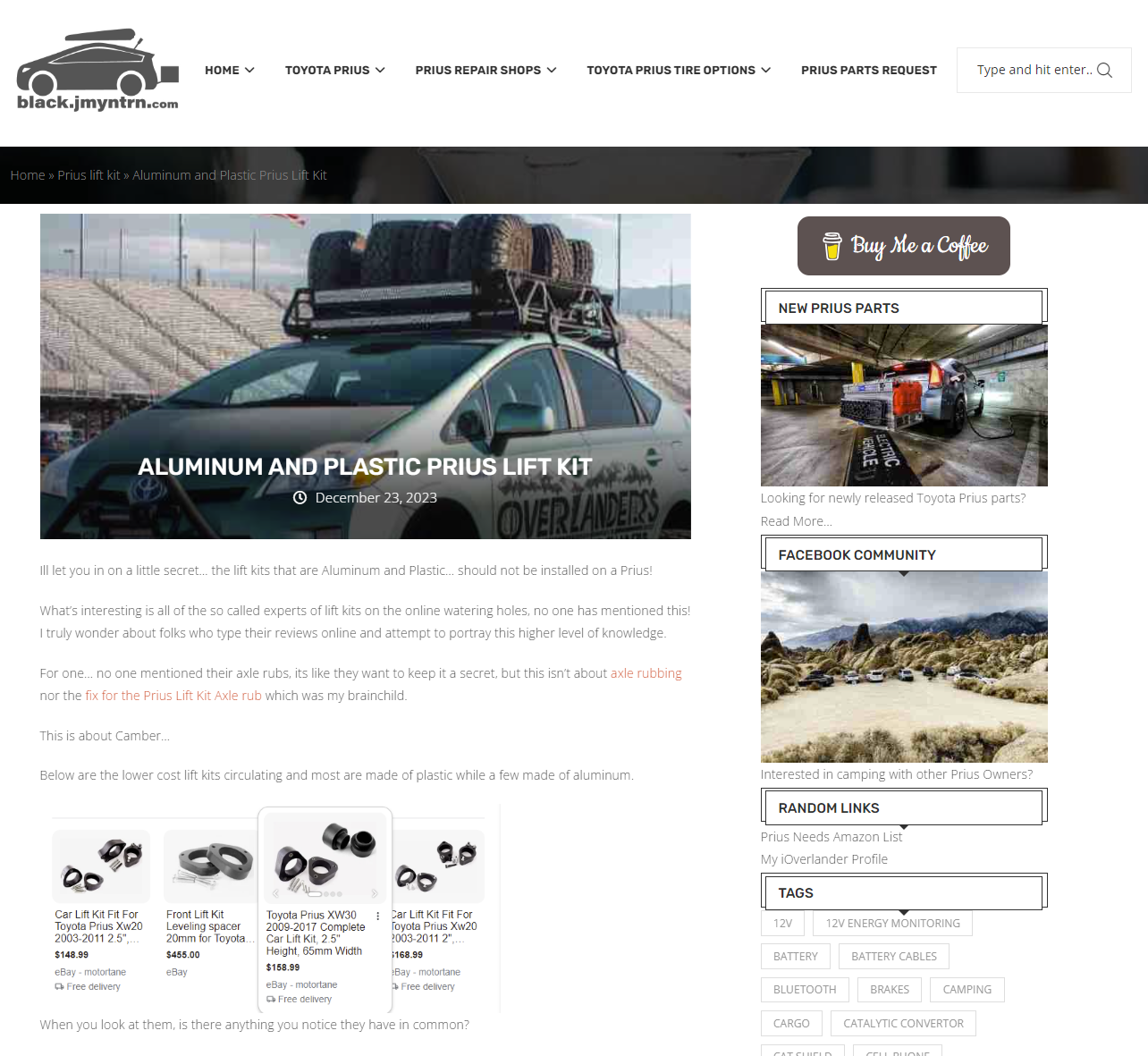

    It's not clear to me how you got your 12" lift. Is the 2" spacer kit from Prius Overlanding a part of the 12" lift that you currently have or did you replace the 2" lift kit with an entirely different 12" kit?
    Can anyone else report on how the 2" kit from Prius Overlanding worked out for you? The FAQ on Prius Offroad goes into how their initial goal was a lift of 2.5" and why they won't sell a kit more than 1.5" has me concerned.

    It's my belief they never even attempted a lift taller than 1.5" because at 1.5" your Axle rubs metal... yet those who support them swear it's okay and that it's nothing to worry about... personally, that wasn't good enough for me and after reading on 4x4 and Jeep forums, they do not take axle rub lightly as something that is okay. That said, I also don't believe they tested that far because it wasn't until the 2" lift was produced did the low cost third world country manufactured kits try to one up the 2" and ALL OF A SUDDEN I am seeing people now say 1.6" and other numbers of how tall their vehicle is lifted by said company. That means they adjusted their original design to exceed the height limitations they initially set themselves... makes you wonder how well it was even tested initially.
    To this day you don't see videos like this of their products in the wild, you only see pictures of vehicles on the pavement...
    https://black.jmyntrn.com/2024/01/06/how-can-i-eliminate-this-axle-rub-it-started-occurring-after-installing-a-prius-off-road-lift-kit-gen-3-prius-1-5-inch-lift/?utm_source=PriusChat&utm_medium=weblinkt&utm_campaign=commentlinkMay
    regarding how... this link below should give you all the answers... so when they say not to install lift springs and a lift kit... again.. they were wrong...
    Prius lift Kit using strut topper and heavy-duty lifting springs! - black_jmyntrn
