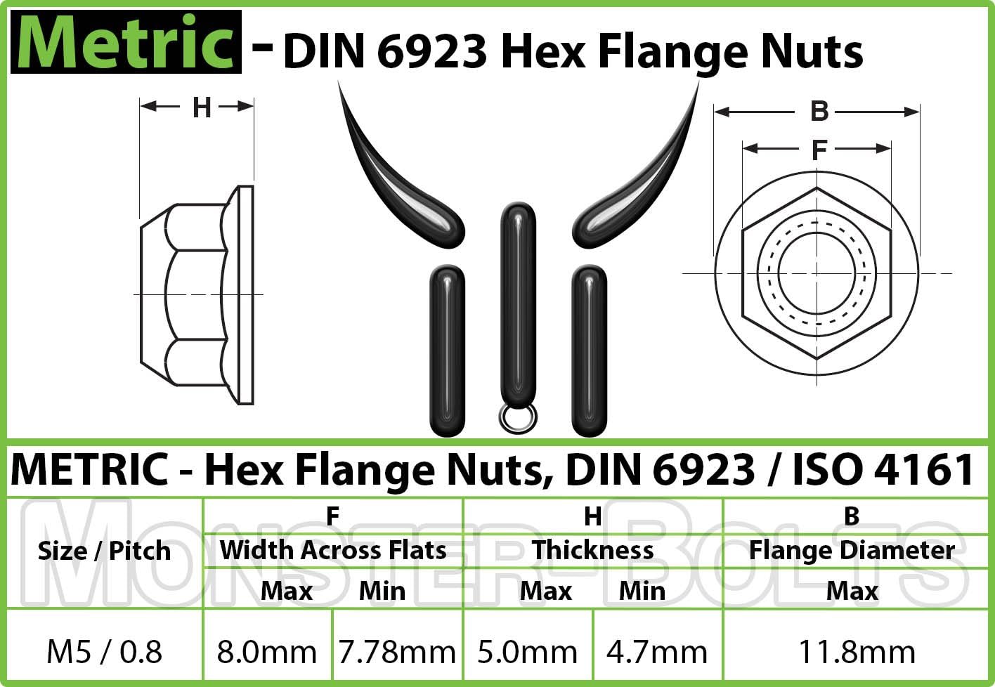

    Does this spec look right?
  18. Toyotally04
    Toyotally04 Member
    Jan 7, 2020
    130
    17
    SoCal.
    The ones I purchased and later returned were smaller than the ones I had taken off from the car. I was expecting the nut height and nut width to be much bigger.
  19. TMR-JWAP
    TMR-JWAP Senior Member
    Aug 12, 2016
    6,404
    6,094
    Columbia, SC
    The one shown in post 17 is the small one. The width across the flats is 8mm, which is also the size socket that will fit it. You need 10mm across the flats. If you PM me an address, I'll send you some.
    Toyotally04 likes this.
