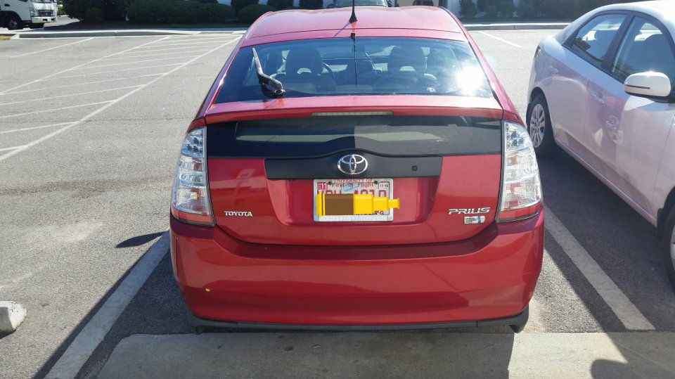

    Ok thanks. I'm buying the amazon aftermarket one for $57 and shipped to my door. I think you can jimmy off the old prius logo from the old part and put it on the new piece. I've seen someone else do that here and they posted a pic at this thread.
    Entire lift gate handle snapped off | PriusChat
  9. JC91006
    JC91006 Senior Member
    Nov 10, 2013
    16,898
    8,629
    That Red Prius looks like my car LOL. It has an OEM black garnish, from a black Prius. It's not aftermarket.

    With all due respect, the post with that red prius said this:
    "Dealership quoted me about $500 to replace it. Part was available online in my Barcelona red color for $255. I bought a aftermarket, non Toyota part off ebay for $45. I decided that I didn't know if Icould ever get paint to match, so I left it the black paint primer color, like another diy replacer on this forum. Glass directly above it is black so it looks different but not odd. With a DEEP 10mm socket ($8 from home Depot) and an automotive pry tool from advance auto (saw it in on a YouTube video), the repair took 3 hours. And That's because I am slow and cautious (plus I had to use goo gone to remove the tape residue). I also had to carefully pry the Toyota symbol and transferred to the new piece. My car lift gate / rear garnish also has the backup camera and the smart button, which weren't hard to fit in the new piece"
  11. JC91006
    Nov 10, 2013
    16,898
    8,629
    I've been corrected. That looks pretty good for non OEM part. I replaced my red garnish with a black oem one from a car I was parting out.
