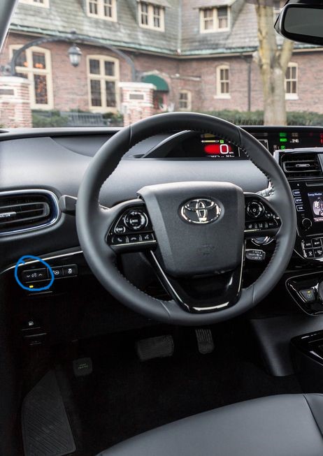

    is there a dash lights adjustable dimmer knob left of the steering wheel around your knee area?

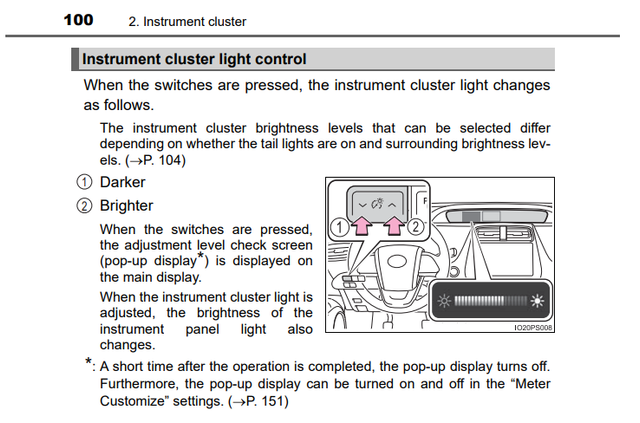

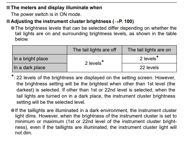

    Check your owners manual around Instrument Cluster Light Control. It might just be your Auto Headlight setting.

    Apologies for disappearing - shortly after I posted, my car was encased in a couple inches of ice. But I figured it out:
    When the dash light dimmer is set to full brightness, as mine usually is, it disables the knob lights. It needs to be at least one click below full brightness. Once in that setting, they'll then turn on only when it's dark out. I'm not sure how that makes any logical sense, and it seems to be only those tiny knob lights that work that way, but there it is!

    Interesting. Kind of matches the manual. Who’d of figured. ;)

    Clear as mud and doesn't reference the lights I'm asking about (which are the only ones that behave differently that the rest), but thanks anyway!
