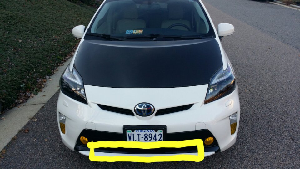

    I had thought about doing one the whole length of my lower part between my factory fogs after seeing a coworker with the led light bar on the roof of his jeep! Never pursued it.... guess it was jus something I thought was really cool for a second. I did have a few sets in my amazon cart for a while haha
    C.R.E.A.M. likes this.

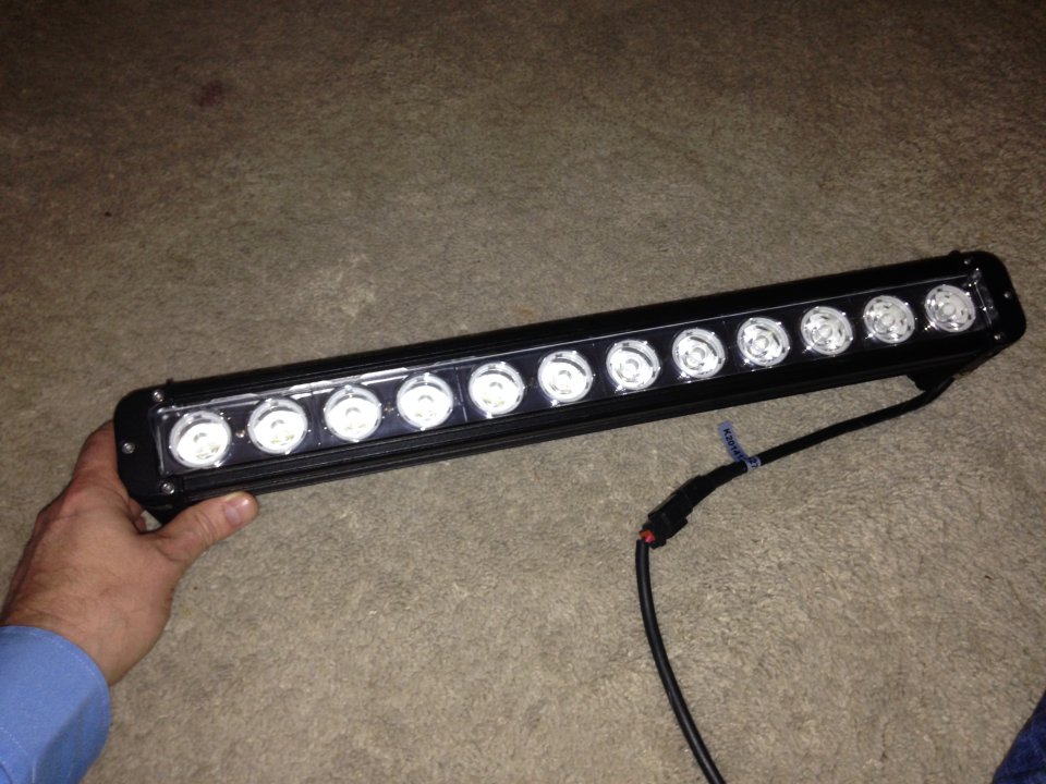

    Ok, the LED bar is here :)
    I am still waiting for a wire harness, but I'll use another one I have on the shelf.
    I am not an expert installer of any of this, but I think it will be ok.
    The LED bars light output is almost a bit too much.
    I'll put up a picture soon.
    If a LED uses 20% of a halogen bulbs energy to output the same amount of light,
    one of these 10w LEDs should equal about 50 watt of halogen light. And there are 12 of them.
    Now how do I sequre the LED bar behind the grill?

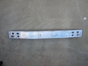

    After a little bit of thinking I have decided to fixt it under the reinforced bumper, upside down.
    The LED bar looks water proof enough, but upside down there will be cavities that can fill up with
    water. I will make it a little bit extra waterproof.
    I will have to drill 4 small holes for the brackets in the reinforced bumper. Hopefully it will be possible
    to do this and enough space to tighten the bolts. I also hope it will come down far enough to be
    visible in the front. If not, I will have to replace the bracket screws with longer ones.
    I'll get some better pictures soon.

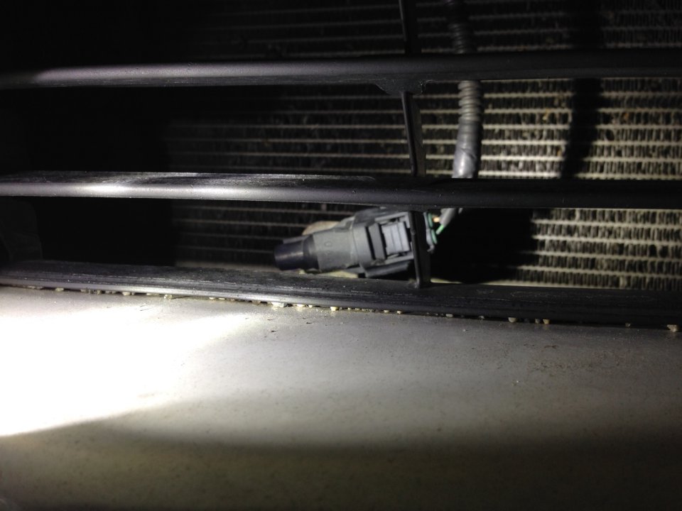

    And I figured out (or actually someone else did in the forum) what the little cable coming down behind the grill is. It is the temperature reader.
  13. alekska
    alekska Active Member
    Feb 14, 2010
    435
    138
    Atl
    The wired thing on the photo (IMG_7672.JPG) is an ambient air temperature sensor. It's not in the place it should be (has a mounting hole in the middle of the grille, on the metal beam)
    (P.S. - just noticed the post before me about the same temp sensor)

    got a link to the light bar you bought?
  19. Palulf
    Palulf Junior Member
    Jul 14, 2012
    68
    24
    Bergen, Norway
  20. Palulf
    Jul 14, 2012
    68
    24
    Bergen, Norway
    Hi
    Thanks for your help. Led bar is mounted. Pictures coming :)
    Do we know which cable in the steering wheel harness is for the high beams? I thought maybe I could tap into that instead.
    Brown is apparently for the parking lights.
