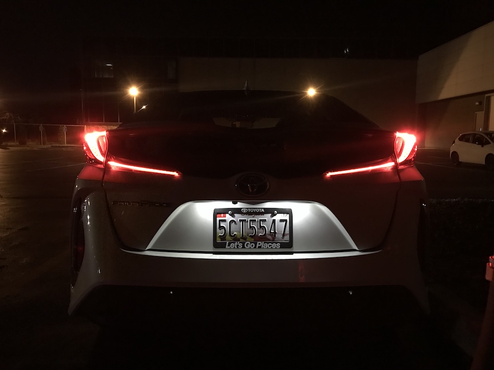

  16. Tideland Prius
    45,422
    16,668
    Because it's a taillight, not a brake light.
    Reading the quote from Reddit again:
    "center brake light lights even when brakes not applied, albeit in lower intensity as a taillight (How is this DOT-legal??)"
    Does that make sense to anyone? "centre brake light lights up even when brakes not applied..." That's because it's NOT a brake light. That's the definition of a tailight. And the "albeit in a lower intensity as a taillight" is exactly it. It's a taillight. The CHMSL in the Gen 5 is a small light mounted on the tailgate.
    False. The centre solid light on the Stinger is the taillight. The individual LED bulbs below are the brake lights. Here's the taillight without the brake lights on. You'll see that the row of LEDs below the lightbar is off.
    Again, false.
    The Prime does NOT have a light bar. You see in the image below that the centre light that you refer to (mistakenly as a light bar) is off.
    I can see where the confusion lies where because the Prime has a CHMSL that mimics a light bar, one thinks the Gen 5's lightbar is the CHMSL but it isn't.
    No, it just doesn't exist. It's to distinguish between the LE and XLE/Limited models. At night, it'll be easy to identify the Gen 5 trim level based on lighting. (Same as Gen 4 with the Touring models vs. non-Touring - they have different parking light designs)

    Could it be that the CHMSL on the Gen 5 Prius LE is located inside the light bar like in the Gen 4 Prius Prime? That would be a better design than the tiny CHMSL located just above the light bar on the Gen 5 Prius XLE and Limited.
    Here are the taillights, light bar, and CHMSL on my Gen 4 Prius Prime. It is a better design than the minimalistic Gen 5 design that is a simple straight line in my opinion.
