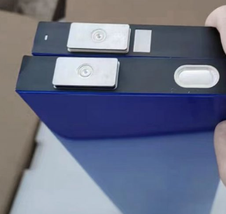

  7. black_jmyntrn
    black_jmyntrn Senior Member
    Oct 23, 2020
    1,729
    411
    2013 Prius Plug-in
    are you sure?
    New cell (in use since 2020)
    • Manufacturer: Panasonic
    • Capacity: 51 Ah
    • Nominal voltage: 3,7 V
    • Energy: 188,7 Wh
    • Form factor: PHEV2
    • Chemistry: NCM 622
