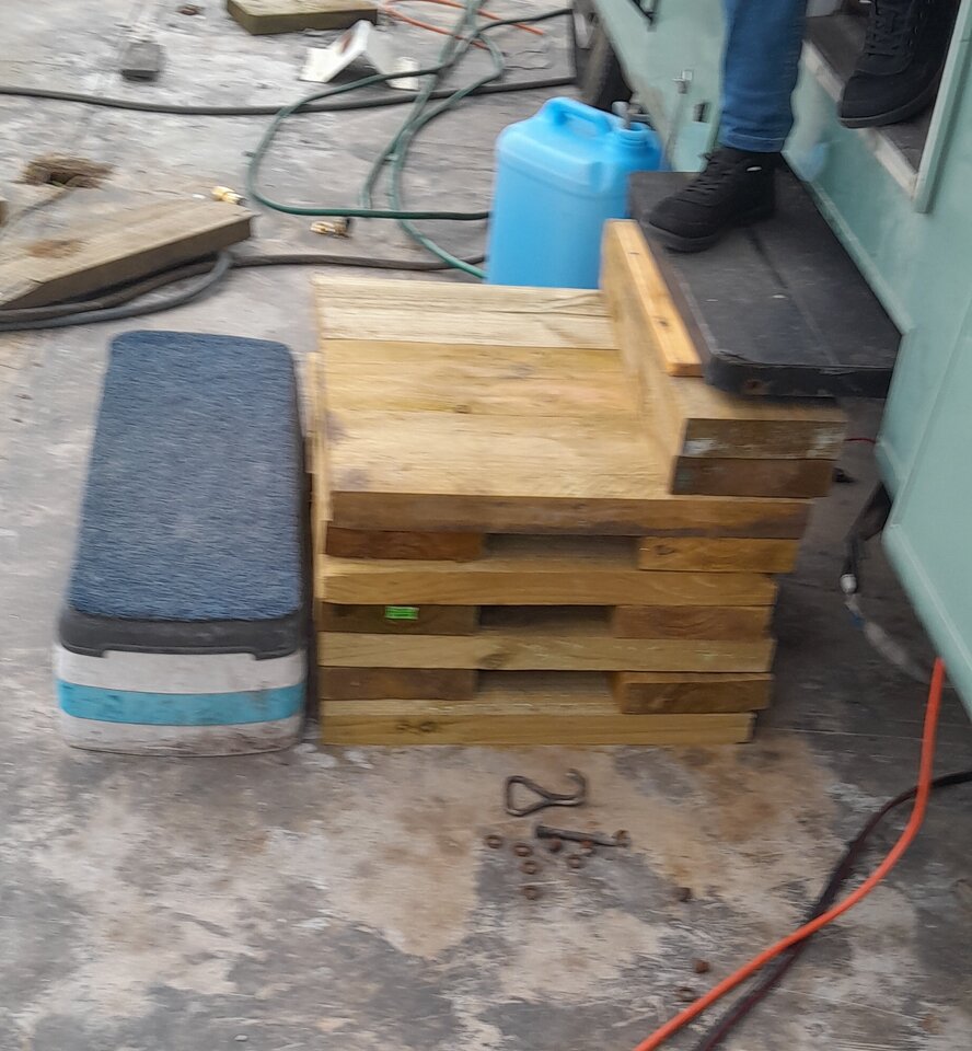

    The latest was to reverse engineer a set of auto folding steps to make a Jenga game instead Reverse engineered steps.jpg
    Managed to get them tangled up with a tree when they didn't auto retract .... some serious straightening and twisted shaft repair required .... but as soon as that is complete, I'll get back to the topic I was in the process of putting forward ideas :)
