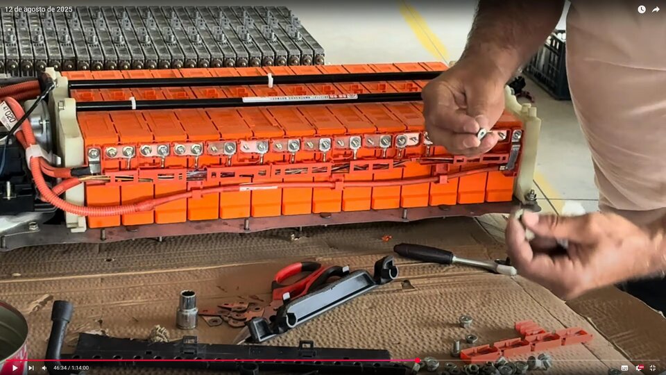

    I'm back from the Mudder channel to post my version of a Li-Ion battery for the Toyota Prius. It's been in testing for several months and has been in development for a year, and it solves all the problems experienced by the Lithium project.
    I know you'll be completely skeptical about a stranger claiming to solve the ongoing problems of a project that's been running for years. But I'm happy to answer any questions you may have.

    How did you solve the battery management system (BMS) issue? Which was the heart of the problem.

    Neat! Some questions I can think of offhand:
    • What chemistry is used?
    • What is the configuration (as _s_p so for example the car's original NiMH battery is 168s1p)?
    • How many intermediate voltages are monitored for management?
    • How is balancing accomplished?
    • Is the car's original battery smart unit with 14 voltage inputs retained? Are those simply attached to the bus bars (as I think I'm seeing in the photo) or to different dedicated terminals?

    There is no need to solve what is not broken. The problem always came from using a technology (Lifepo4) and insisting on it that it was not valid for the use that was being given to it (high discharge).
    In addition, it does not even match in voltage ni-mh and lifepo4
  18. Vencedor
    Vencedor New Member
    Sep 3, 2025
    17
    Spain
    The solution was always the Li-Ion because it matches perfectly with the voltage of the ni-mh. The configuration is 56S 3P 12Ah. Intermediate voltages are not measured, cells are not balanced. Direct swap with the bus bar of the car. A properly made battery does not need active balancing
