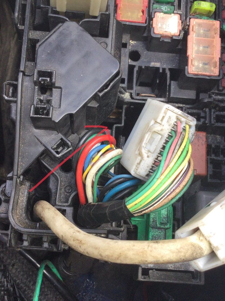

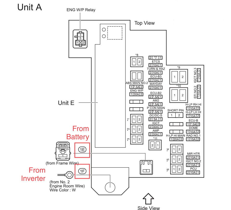

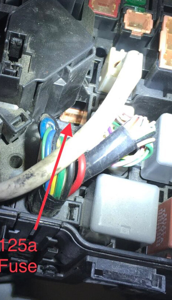

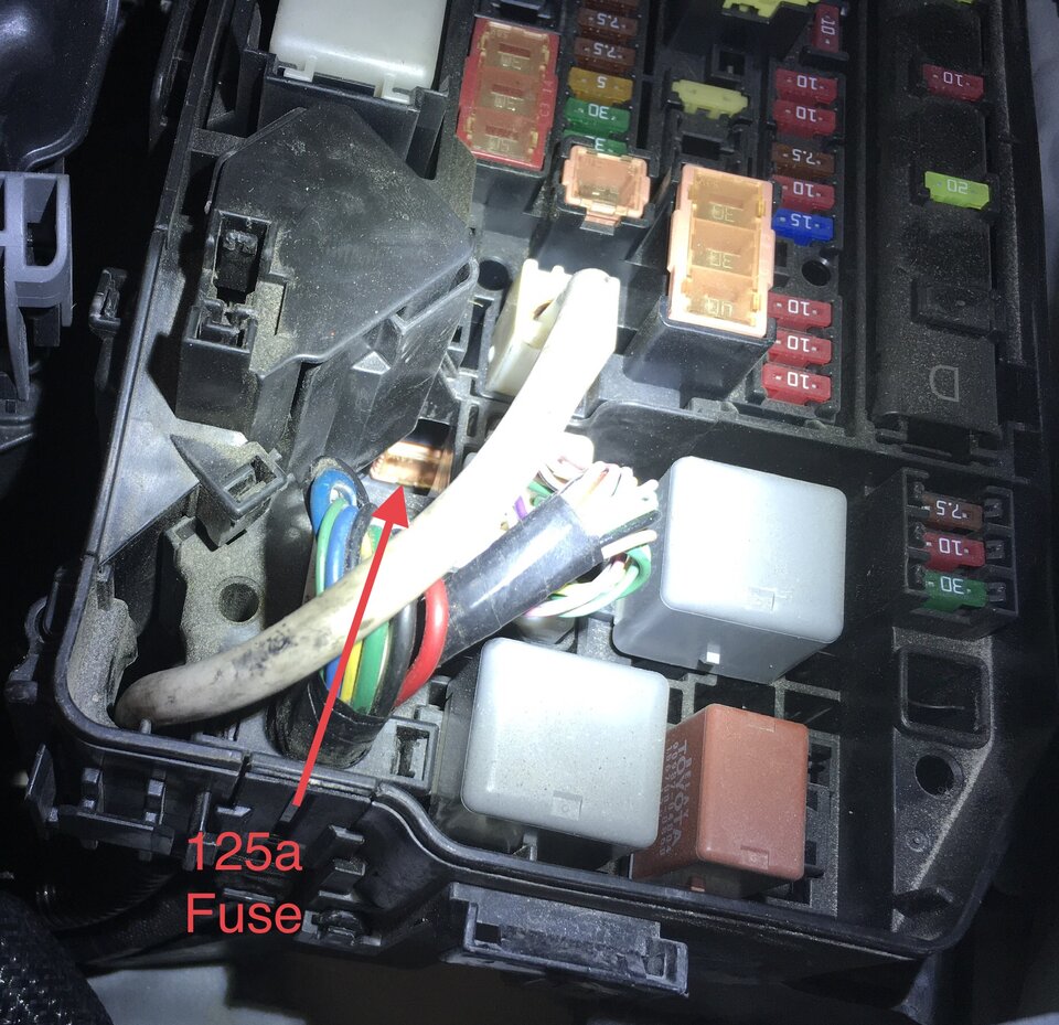

    If you shorted wire 1F that connects the inverter 12v to the 12v battery, your 125amp fusible link buried inside the engine fuse box is blown.
    With a flashlight at an angle you can see the link
    You can also check for 12v downstream of the 125a link. One location is the 30A Eng WP (Engine Water Pump) fuse

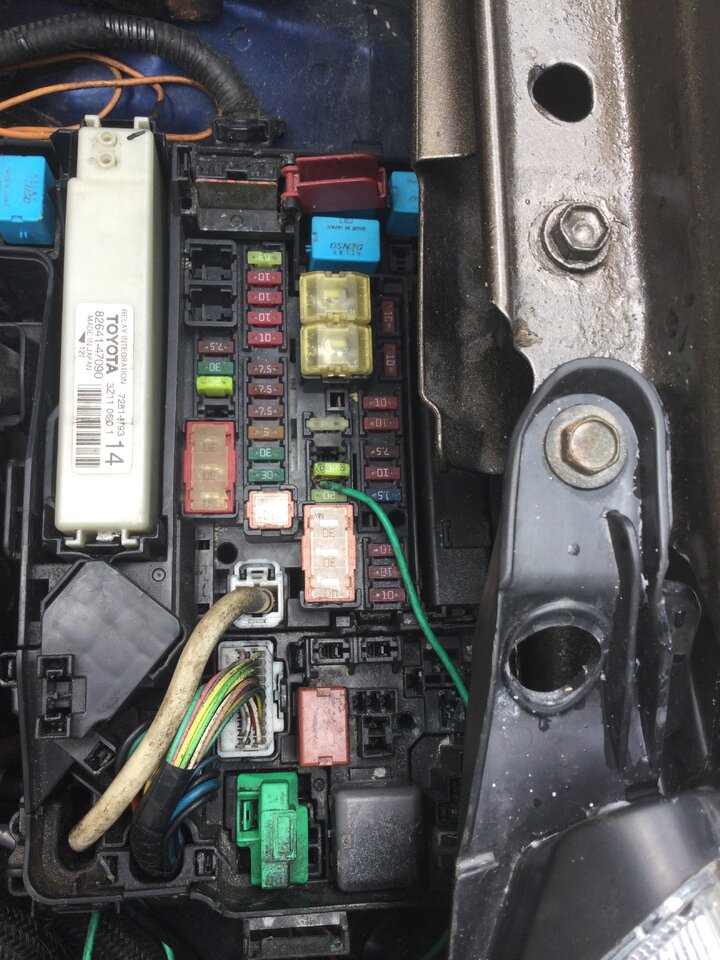

    In removed the fuse box but did not see any fuse under
  8. rjparker
    rjparker Tu Humilde Sirviente
    Jun 6, 2008
    11,129
    6,982
    Texas Hill Country
    The 125a fusible link is inside the engine fuse box. See pic above.
  9. 473 Prius v
    473 Prius v Junior Member
    Oct 2, 2023
    27
    Grenada
    2014 Prius v wagon
    I can’t find it

    That’s a picture of my fuse box
  11. rjparker
    Jun 6, 2008
    11,129
    6,982
    Texas Hill Country
    Use a flashlight

    I think I finally recognize it even after I previously took the box out. So. An you please tell me how do I check it and if blown how can I fix it keep I. Mind I’m outside the US on a small Caribbean island with limited resources

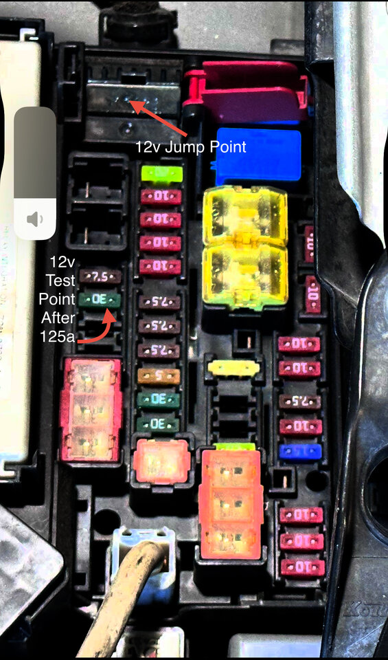

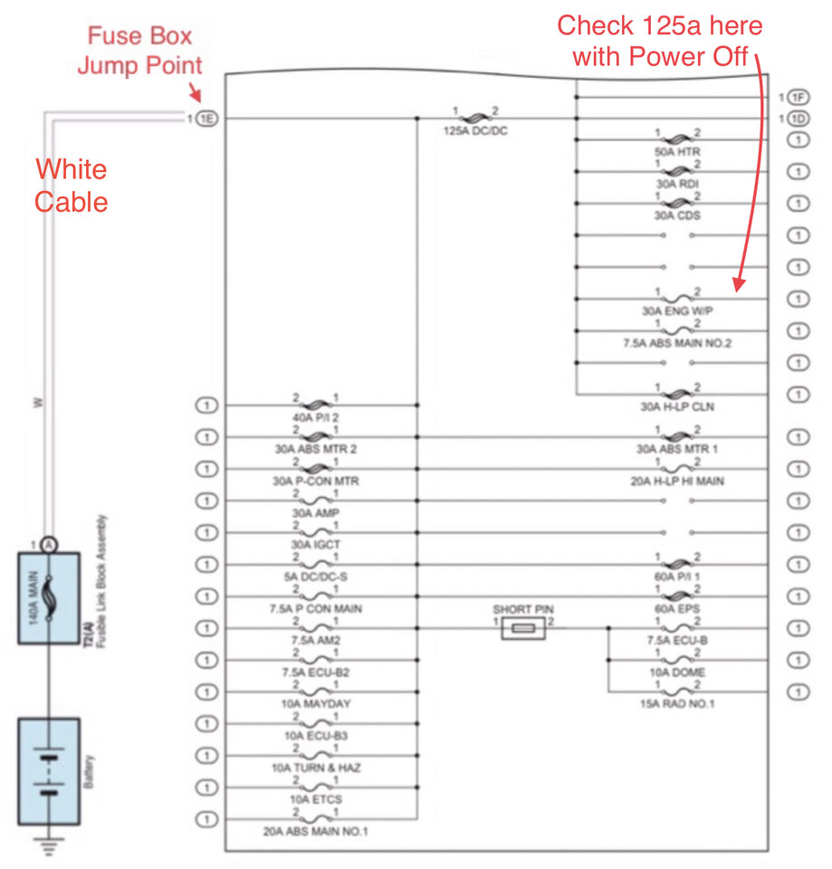

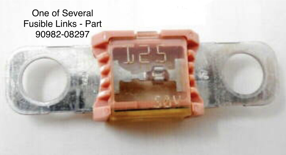

    I will assume your short was 12v from the inverter to the fuse box. The 125a fuse connects that point to the white battery cable.
    In post 2 the diagram shows another 140a fuse link at the battery in the 12v terminal. Check it as well. A voltmeter check before tearing it apart would have quickly isolated the problem.
    Part number in pic of new part. The fuse box comes apart in sections but not easily. Verify the 125a using a meter first.
    See "12v Test Point" in pic below.
    With the fuse box out it might be easier to use the meter in ohms mode between the two points. Continuity (0-2 ohms) would suggest the 125a is good.
