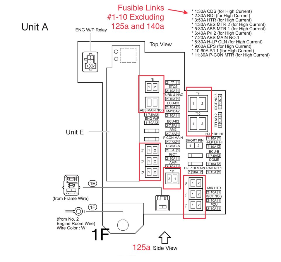

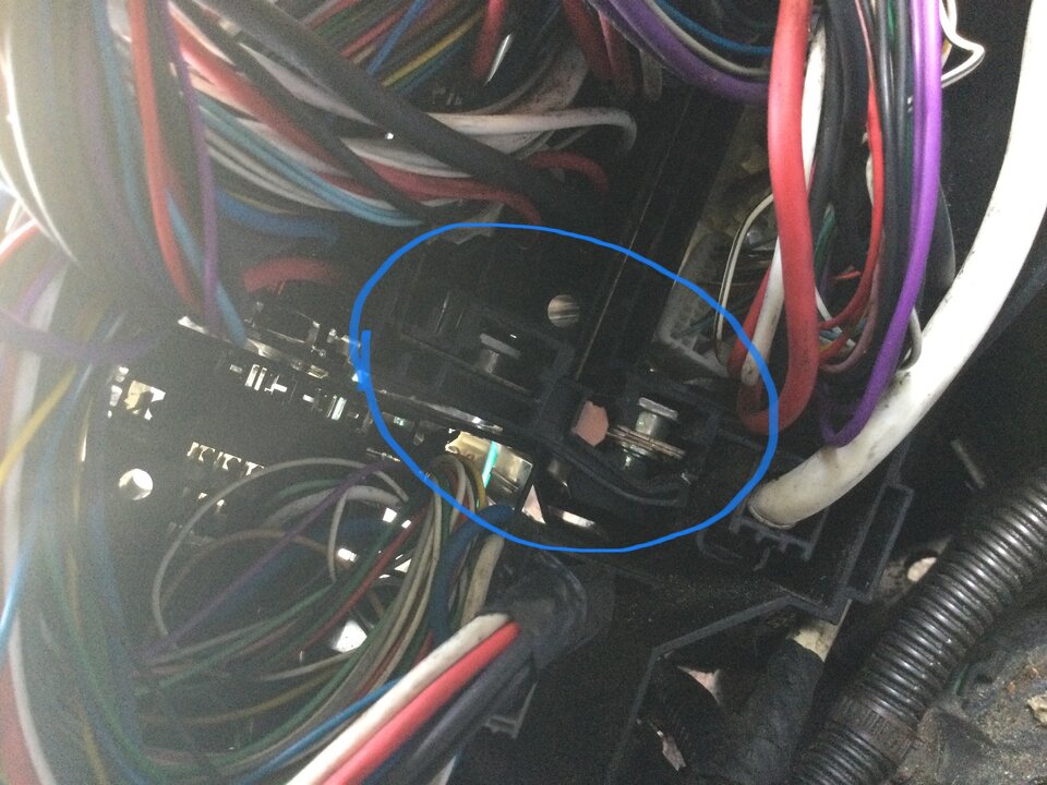

    Good day all. So I finally got the time to remove the fuse box and locate the fuse we talked about I’ve tested it with a multi meter and yet seems to be ok however since I already bought one I wanted to replace Anyone ever changed it before be I don’t know to remove it I think I feel a small screw probably an 8mm. Any ideas will be greatly appreciated also if the fuse is good any other ideas what I can check. Is it possible my ecu I’d damaged ?

    I finally got the time to work on the car I pulled out the fuse box got access to the fuse checked with a multi meter and it’s good I still wants to change it but I don’t know how to remove it any ideas? Also being as the fuse is good that’s still leaves me wondering what could be wrong with my car

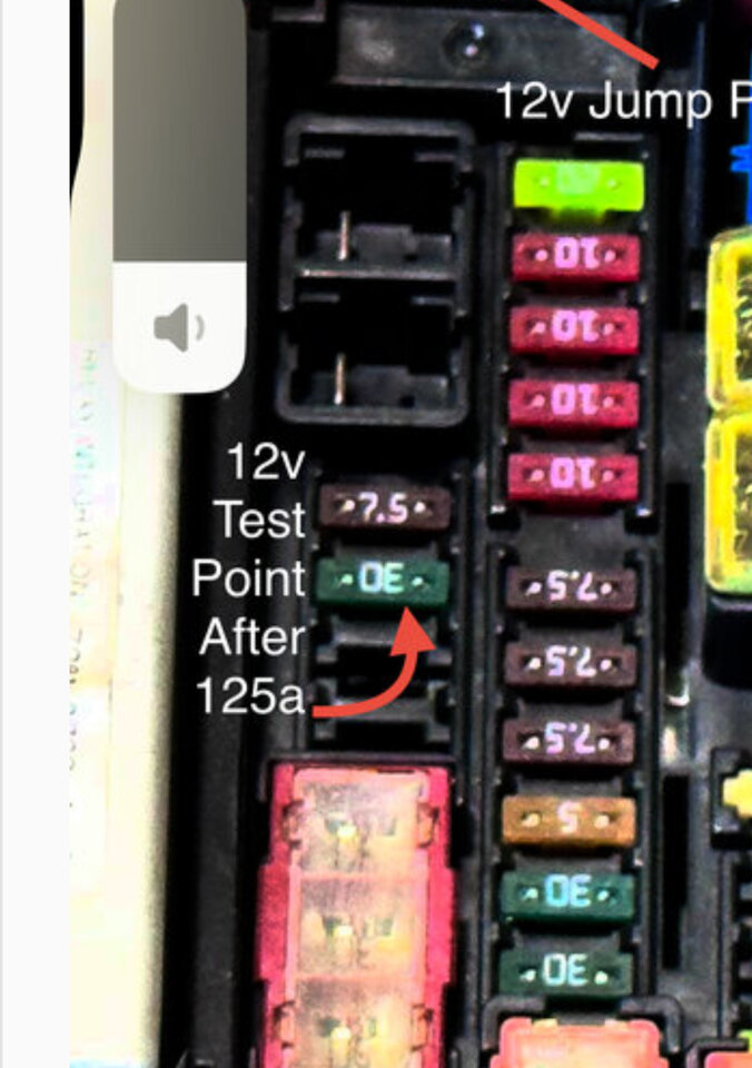

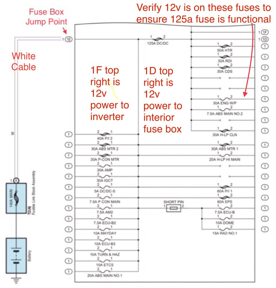

    If it's good leave it in.
    How exactly did you check the 125a fuse without accessing it?
    Did you check the 140a fuse at the 12v battery?
    You really need to check the 12v at various points when it is all connected based on the diagram.

    I flipped the fuse box and was able to see it I touched both sides with a multi meter to and got the beep

    Where is the 140a fuse located?
