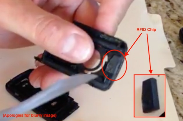

    If you have SKS, you will have the little black buttons on the front door handles and (if stock) a silver Toyota logo on the back of your current fob.
    Tom is making assumptions based on what he thinks you mean by "so despite a new FOB battery, the lock/unlock buttons don't work." The physical lock/unlock buttons on the board are likely fine.
    One last point that no one has mentioned, in addition to transferring the circuit board over, you will need to transfer the RFID chip over as well. The RFID chip is what allows the car to start when you insert the fob in the slot.

    If you change the case, don't forget to transfer the chip as well.
    I did this and had to dig out the old case from the refuse.
