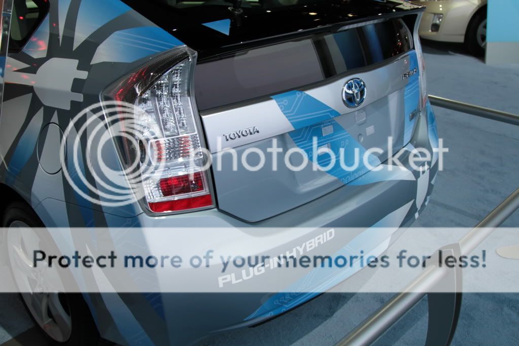

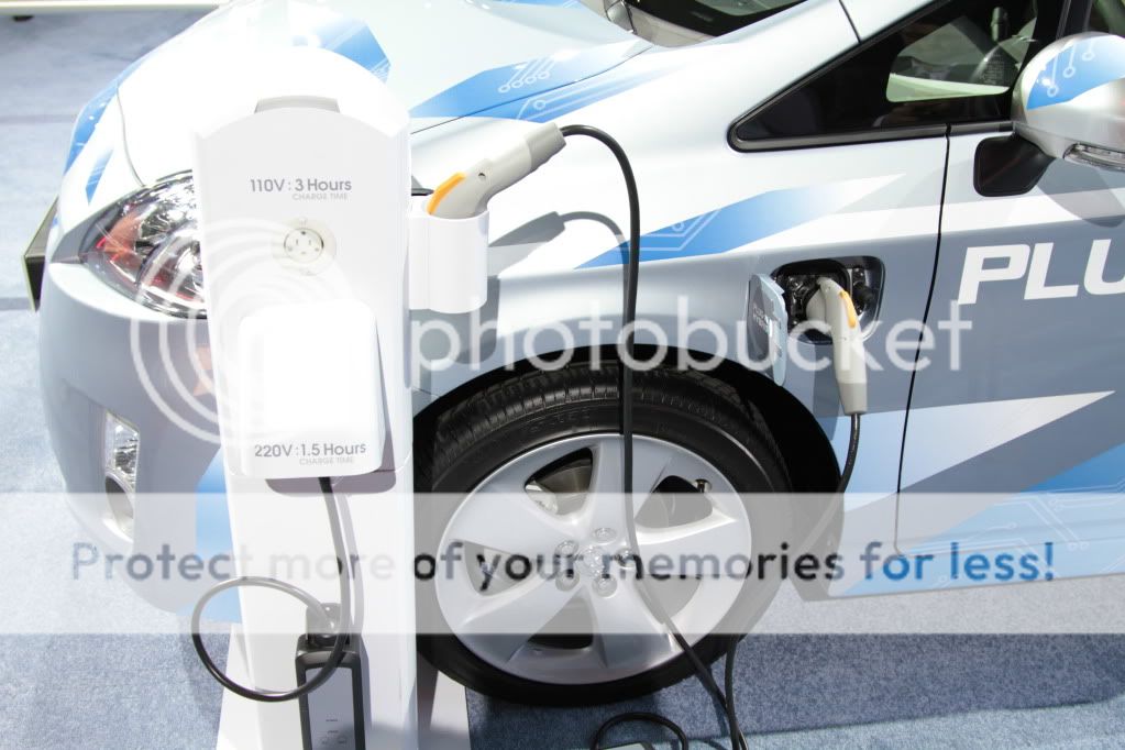

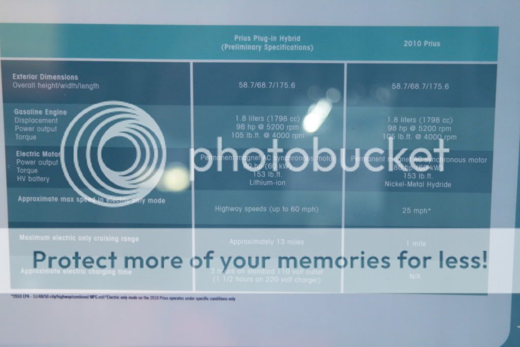

    I am covering the LA auto show and my first stop was Toyota to check out the plug in Prius. I wish it had more range on just electric (13 miles up to 60 MPH) but this is just the beginning.

    Hmmm... So they're showcasing this puppy with Halogens, Fog Lights and Mirror Turn Signals...
    What I would really love to see would be any changes in the dash display.
    Did anything in the interior look any different perhaps?
    No antenna?
    Just wondering...

    My guess is the PHV is in the depletion mode for the initial 13 mile in EV mode, from full to say 20% SOC.
    Then, it goes to the sustaining mode for the rest of hybrid driving, trying to keep the 20% target SOC (60% target SOC on the normal Prius).
    However, it has a lot of room for storing the regen energy on the long downhill.

    That sucks. It'll be nice if it kept the 60% mode so that we can use it if we get stuck in traffic rather than have the engine idle when we're stopped. I guess it doesn't know if we want it empty so that we can charge it later or whether to keep it topped like a regular Prius. Perhaps Toyota can have a "PHEV" mode which covers EV Drive Mode and tells the car not to top up the battery. If the driver takes it out of PHEV mode, it will top it up.
    Btw, anyone noticed it was a French Prius? It's LHD and has a rear foglight on the driver's side. It's the same Prius shown in France.

    I think you have to understand the depletion mode and sustaining mode more. :)
    The 13 mile EV range uses 70% (90%-20%) of the battery capacity.
    If it kept 60% SOC for the sustaining mode, you can use only 90%(my guess) to 60%, which means your EV range (using 30% of capacity) becomes only 5.6 mile.
    We see 40% to 80% (target 60%) SOC on the regular Prius.
    My guess is the battery capacity of plug-in is more than 3 times of the regular Prius.
    Then, we'll see 13% to 26% (target 20%) in the sustaining mode of the plug-in.

    It's then much as other plug-in hybrids - charge depletion (not depression, Ken) down to a specific level, then charge-sustaining below that level.
    Think of it as a current Prius but instead of having 8 bars on the battery meter, with the car targetting six out of eight, it has 40 bars and targets six out of 40. The only real difference is that in charge-sustaining mode it won't be trying to spin the ICE to burn off the eighth bar of charge after a long mountain descent.
    By asking for a 60% maintained charge you're asking the car to run the engine excessively to charge up from six bars to 24 bars, which is way more than it needs right now to achieve 50mpg. Calculations have already shown that you get diminishing returns from extra capacity in a charge-sustaining hybrid, and Toyota have ruled out Li-Ion for regular hybrids for this reason.
    The Prius behaviour is to be more aggressive the further away it is from the sustained-charge level, so you'd really be consuming way more fuel. The point is to get those electrons from external sources, not to burn on-board fuel relatively inefficiently.
    The specs don't say what the fuel tank capacity will be, but the video (on another thread) seems to indicate a new charger unit in that vicinity which will reduce capacity a bit. The battery largely takes the place of the spare tyre and under-floor storage space on the current car.
