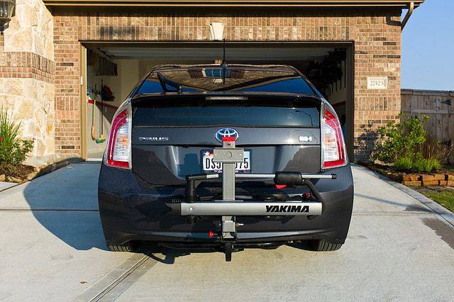

    The following is just my thoughts based on previous experience...
    The helium is good option if you don't mind clamping over the top tubes (may not be a good choice if you have carbon frames) and having your bikes at funky angles (see pics in that link above), since most bikes today have angled top tubes. Some frames like full suspension mountain bikes are really difficult to slide on to that type of rack, too since their is not much space left in the frame, especially when you have to slide it back to the second or third mounting point. You'll also have to secure the wheels with a bungie or strap or something so they are not dangling around. I like the look of this type of rack sans bikes for it's minimalist style, but in actual use I prefer the tray style. Another thing... look at the pics in that link. Notice how far out there that bike is? Then look at the side view of mine here:
    I'm not meaning to bash the helium style rack. It's just that after using all kinds, I really prefer the tray style for all the reasons mentioned above, and IMHO of course, it's worth the extra weight. YMMV.
