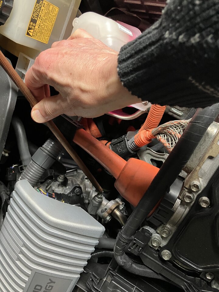

    @HamiltonPrius , I bought a jump pack a little while ago, but never thought how I'd hook it up.
    Those leads really are short.
    There are some grounds in the vicinity of the "exclusive jump starting terminal".
    A couple seem to be on the inverter (?). Seem more robusto than the body grounds also in the area.
    Safe to use? Pic below:

    Yeah, I generally glom onto one of the bolts holding the inverter case together. As the 12-volt system ground originates there, I don't look too hard for a better ground somewhere else.

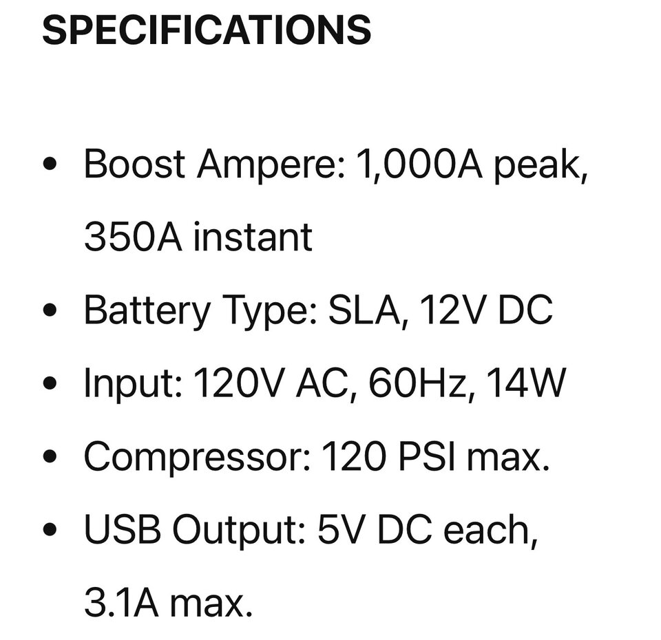

    To be frank, that unit is not lithium which is superior for occasional usage and months long standby. Instead it has a sealed lead acid (sla) battery the size of some alarm systems.

    It's good enough for our Prius; but probably not enough for a V6 or larger engine, or diesel. I didn't take a close look at that unit, but I'm pretty sure there's a battery test button and 120VAC rechargeable. Just need to hit the battery test button before tossing it in the trunk for a road trip. I'm pretty sure that battery is replaceable for around $40 - whereas those mini-lithium ones are disposable. Hopefully, you don't drop that unit too often - other than that, they're pretty bullet proof.

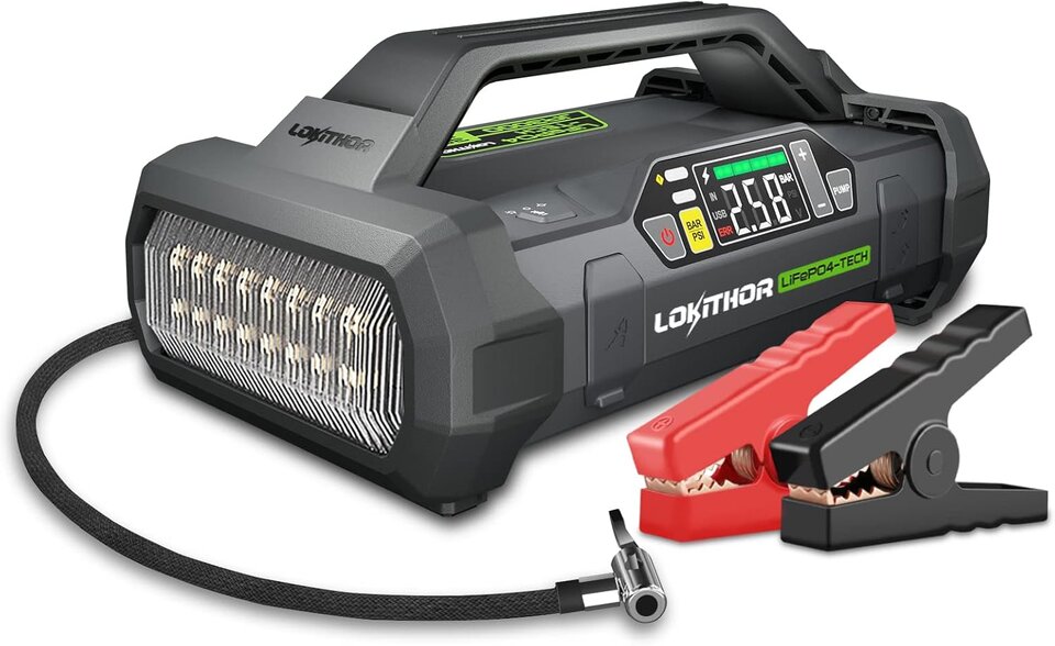

    I'm using Lokithor because it's the only good one I know that is using LiFePO4 battery chemistry. I've used it a few times to jump completely drained batteries and used it from storage and not fully charged. I'm paranoid about leaving lithium ion batteries in a hot car that can go over 100F easily on a daily basis. These chemistries don't catch fire and can be drained to 0 without harm to the battery and last over 2000 cycles down to zero. This one at Amazon has a compressor and is $144 now at 40% off.
    LOKITHOR JA3000 Jump Starter with Air Compressor, 3000Amp 12V Lithium Iron Phosphate
    This is my unit. It has been sitting around for years and still showing a full bar.

    Hopefully it will work when you really need it.
