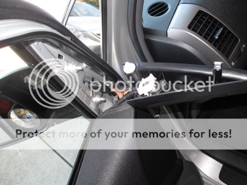

    Ok, I replaced all four door weatherstripping on my 2005 prius myself. Took me about 30 min to do it.
    Alanh's post was generally correct but he left out a few details.
    1. Buy a plastic chisel so you can pry off the old weatherstripping without killing your paint job. (Amazon.com: Car Audio Dash Removal Plastic Pry Tool Yellow 2 Pcs: Car Electronics)
    2. If you have JBL speakers you can just yank them off and it will look like the photo below.
    3. Undo all three of the bolts. Then the rear view mirror can be removed to let it hang.
    4. Don't freak out if the metal or plastic clip stays in the door frame. You can punch it out from the other side.
    5. Use the plastic shim to pry up the door weatherstripping. You want to sorta push it into the window a bit. It will maul the white plastic clip but who cares.
    6. Then with your hand, push in the new weatherstripping until you hear it *click* into place.
    7. The rear doors are really easy since there's no rear view mirror to block anything.

    So I managed to do this... thanks to this thread!
    But the white plastic clip which held the speaker in place either vanished as I removed it or fell into the door or was never there... and now I cannot reattach as tightly as it was held in place originally...
    Where/how can I get an exact size match replacement clip? I don't have the old one for reference...

    Visit your local Toyota dealer parts department and ask the clerk for assistance... Maybe you will be able to find the clip in the exploded parts diagram that the clerk can bring up on the PC display.

    You will most likely find the metal clip behind the triangle rubber gasket between the mirror and door frame. Remove the three 10mm bolts and pull the gasket away and see if it is there. If it is not there I will post a part number tomorrow when I get to the shop. I ordered 10 of these the last time I thought I lost one and haven't used one since.
