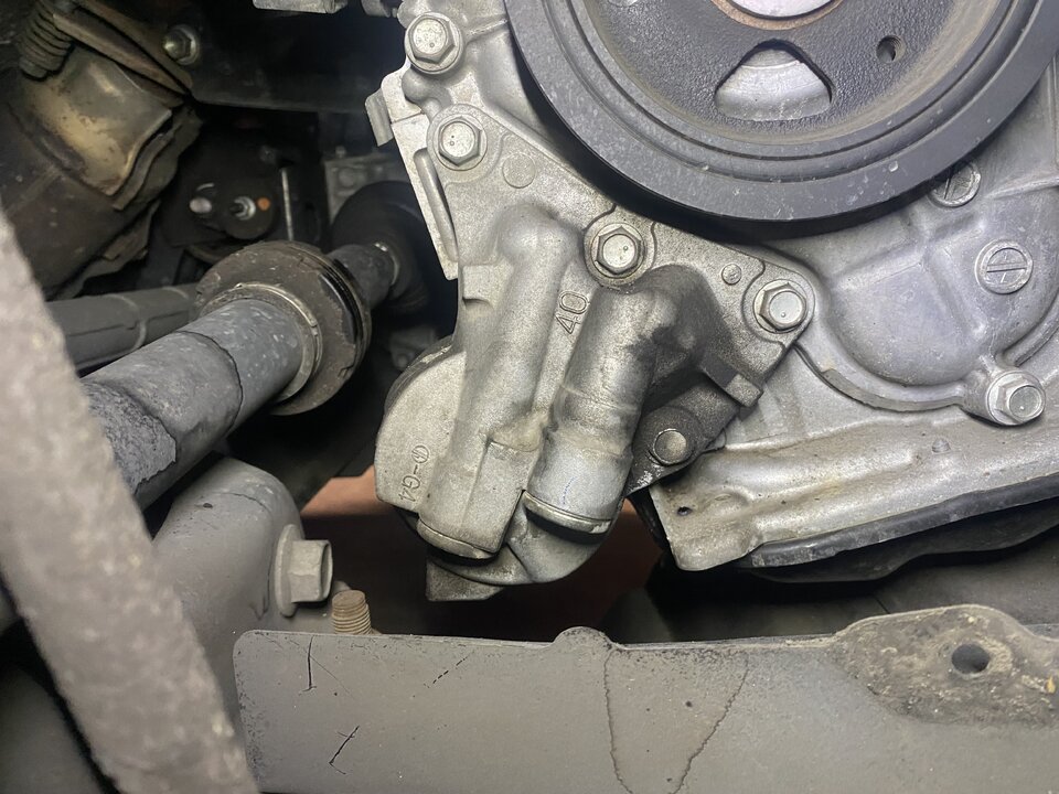

    Thanks for everyone's help. Yes the gaskets is what I'm looking for. Thanks for the part numbers Mendel. I'm currently having rough start and idles. Now heres a series of questions. 1st image; what is this and is it supposed to be out like that?

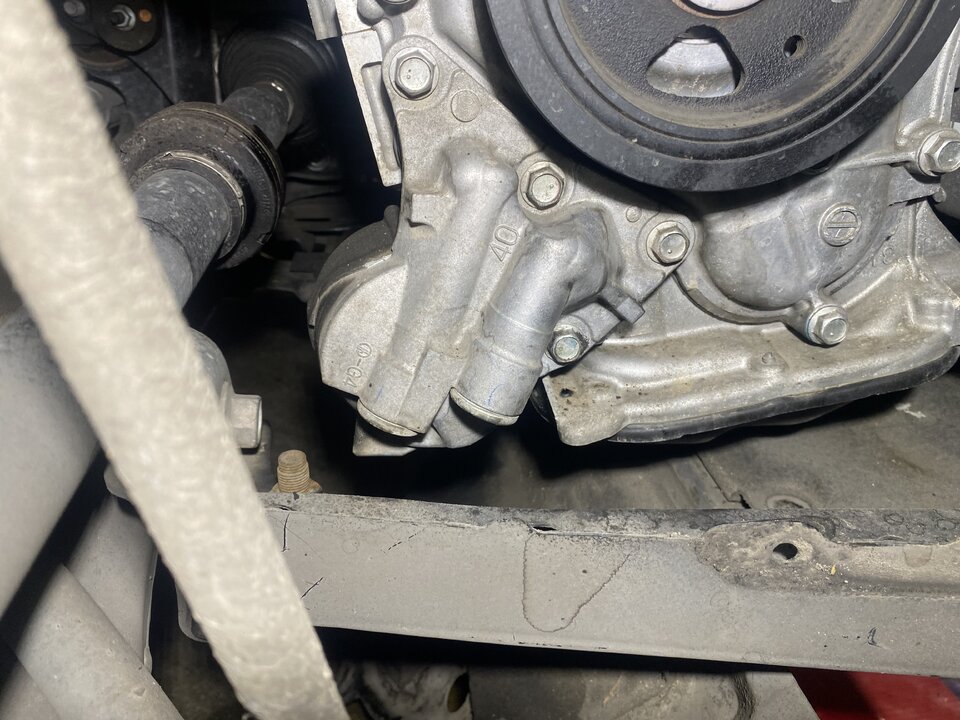

    2nd image; timing chain tensioner, should I replace full assembly or just gasket? Also does removing it cause oil to leak from the location?

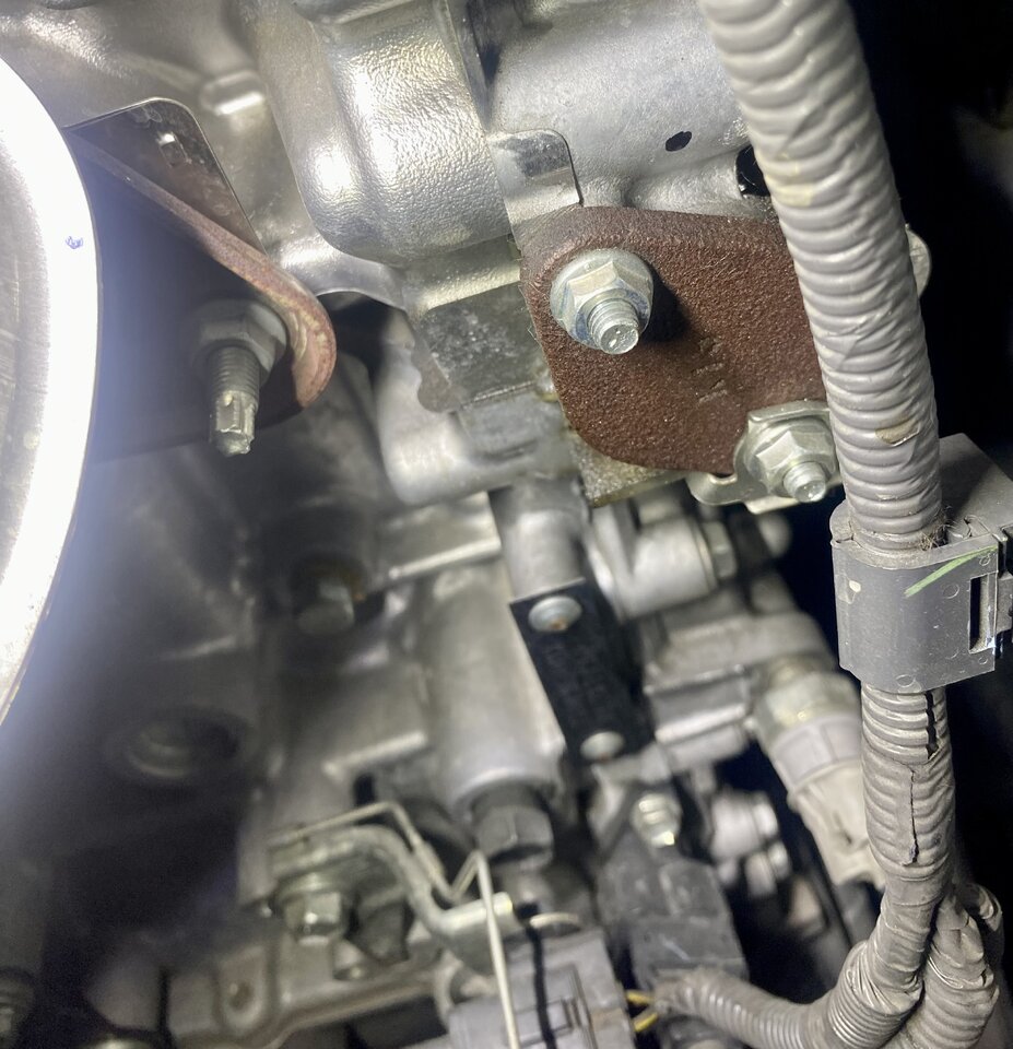

    3rd image; what do you guys think about that o2 sensor? Is it needing replace or is there a cheaper method if it is needing replace. Oem hurts lol.

    Oil pressure switch, and it's not leaking.
    Hard to tell is the tensioner is leaking, you'll have to clean it off and drive it to see.
    And you'll only need to seal/gasket. Some people put permatex on it, just in case.
    If you remove it, make sure you rotate the engine to TDC for #1, and SLOWLY remove it.
    After you reinstall it, rotate the engine backward slowly until you hear it click which releases
    the tensioner. That way there is less chance of the chain jumping a tooth.
    There's no reason to replace the o2 sensor unless it is not working.
  9. Mendel Leisk
    61,612
    42,385
    Why is cyl one TDC needed, for timing marks?
    Any tricks for determining cyl one is at TDC, say other than something like a dowel in in the spark plug hole? And of course to accomplish that you have remove wipers and cowl.
    Also, would it need to be TDC of compression stroke, or doesn’t matter.
  10. Mendel Leisk
    61,612
    42,385
    Looking in Repair Manual, timing chain tensioner install is preceded by setting cylinder one piston to TDC of compression stroke, and check of timing chain marks. But this is in the full reassemble process. So is this still necessary, if you're subsequently pulling it out for gasket replacement? Not sure.
