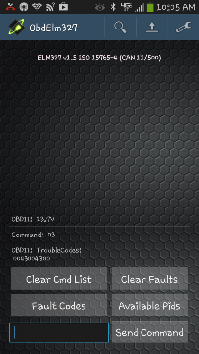

    I have a maintenance light on in my 2004 Prius. I'm guessing it's on since it's due for an oil change? The OBDII program I'm using shows OBDII:13.7v, command: 03, ODBII troublecodes: 0043004300. I'm having the hardest time finding this code anywhere. perhaps it's like hex or number sets?
    thanks for your help in advance.

    I've got the same code coming from my cheap chinese elm357 knockoff.
    I think i'll send a 'clear all codes' and see if it was just left over in the machine's image.

    How long have you had this car? The maintenance light is just a reminder light, doesn't get picked up as a trouble code.
