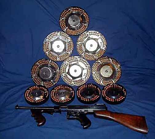

    My interest is more of an engineering question. But it might be easier just to take the dimensions of a full-size, spare tire, and sketch out how many 18650 or 21700/2170 cells could fit in the space. Once I know the dimensions, I can use the Webber State video to figure out the cell-to-cell wiring and heat-pipe style, exchanger.
    My inspiration:
    Unlike a machine gun drum, once assembled, there is no further mechanical motion of the cells. They are assembled with buss wires, wire bonded in a parallel-series assembly. Because there is no relative motion, the spiral can go all the way to the center.
    A prototype using perforated disk-manifolds would be initially used with forced air heating and cooling. But ducting and heat exchangers reduces the number of cells. However, everything would be built using ammonia safe metal, primarily aluminum and aluminum wire. After materials testing, the units would use heat-pipe architecture and ammonia to keep everything at the same, battery-happy, temperature.
