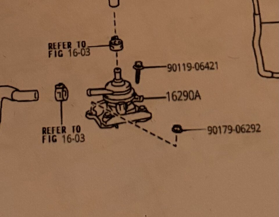

    hey guys im going to get my inverter water pump replaced soon, i am looking information on three things.
    i want to get new clamps for the hose, bolts and nuts and the metal bracket.

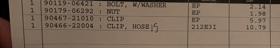

    the parts dude told me it uses bolts and nuts how many bolts or nuts do i get?

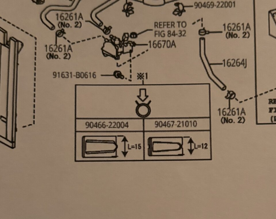

    he also told me the hose clamp is either 15 inch or 12 inch does anyone know which one it is?

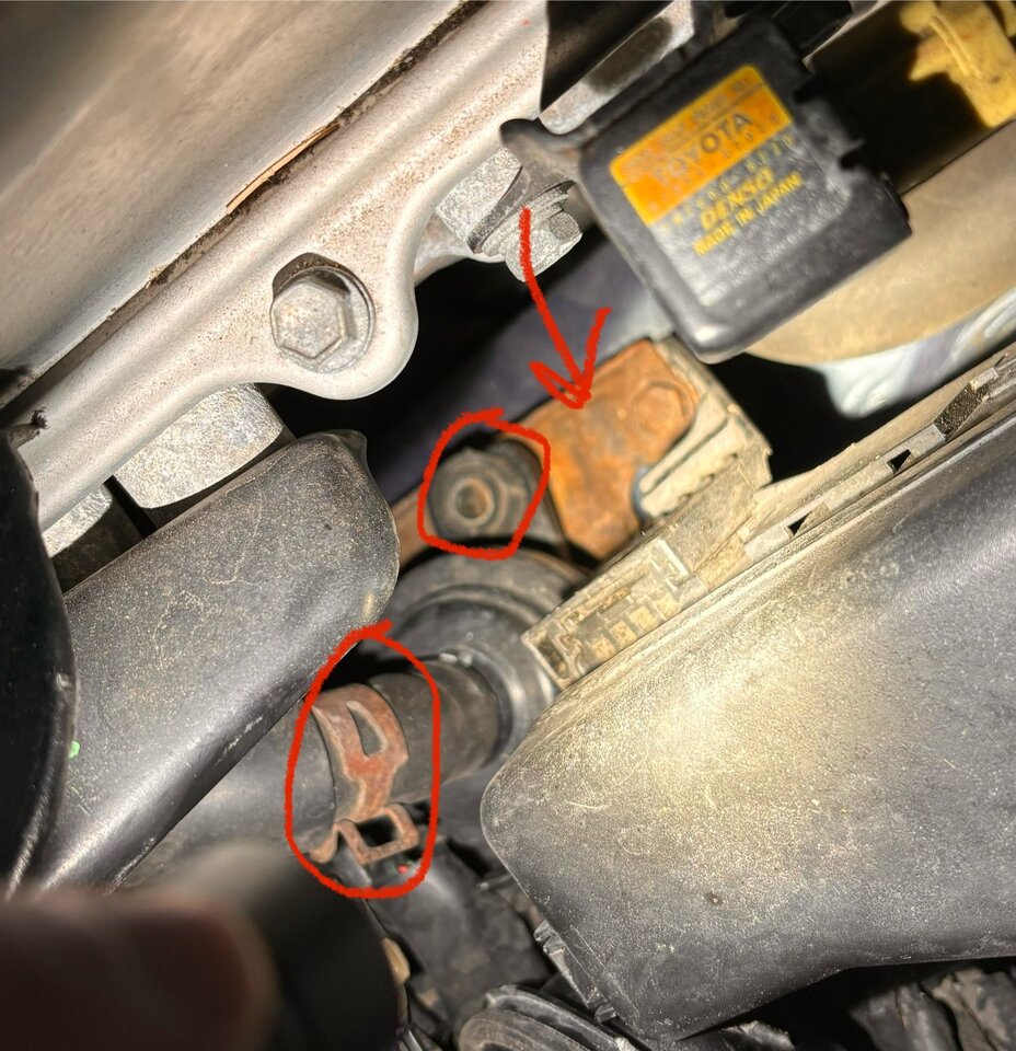

    my inverter water pump has rust hose clamps and metal bracket and currently missing a bolt in one of the holes

    None of this is necessary, it's a super low pressure pump and all existing hardware has a lifespan way longer than the vehicle.

    As others state, reuse those parts. There's a 6mm stud holding one corner of the bracket - it WILL be seized and almost certainly will snap off if forced. I would take slightly rusty OE spring clamps over crappy AM screw clamps any day.

    You're not going to get the bracket out of the car in the rust belt very easily leave it the bolts needed can be removed from front fenders license plates etc of other cars Corolla included no they don't have this pump but plenty of bolts . My Western Massachusetts 08 prius outside all its life that bracket is still gold and so are the bolt heads today .. it's in NC USA now with me .

    What others have said... if the bracket is sound, leave it be. Those bolts are a bear to get at and if you shear one you are SOL. Mount your new pump on the OE bracket, bleed it carefully with the clear plastic hose and you're ready to go. The original pump on my 09 quit at 261700 mi. Just turned 321000 and still running fine...
