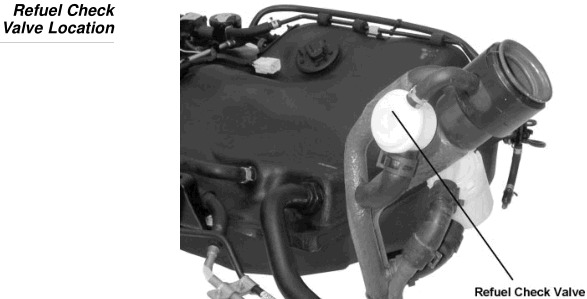

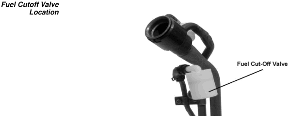

    I agree that blindly waving off serious hard-to-fill problems as "oh, that's the bladder" is usually the wrong call. The bladder can be the answer for mild questions like "how come I could fill 8.3 gallons last week but only 7.8 today?". When there's a serious issue preventing refueling even a few gallons, or sloshing them back out at you, generally something in the ORVR system needs to be fixed, and when it's fixed you won't have that problem anymore, and can go back to just the usual bladder questions about slight differences in how full is full.
    But beware, the canister itself will not always be the root of the problem. We've had threads here where the refuel check or fuel cutoff valves were the culprits.

    Where is that sniffer, and what error code is thrown by it?
    I know there's a pressure sensor, which is used during the routine EVAP system testing that checks for leaks (by watching the pressure response under different vacuum and solenoid-valve conditions). I'm not aware of any sniffer to recognize gas fumes.
    As you've noticed, it takes a little widening of your assumptions to fit what Toyota actually built.
    The illustrations I use are from an 18-page University of Toyota course module you can find in the Technical Library section of TIS. https://priuschat.com/wiki/toyota-service-information-and-where-to-find-it/
    It's not always certain that the canister is what needs replacement when there's an ORVR refueling problem. Pump nozzles have a sensitive pressure-responding mechanism that shuts them off, and there are a bunch of Prius ORVR components that interact with that on purpose so the nozzle shuts off when it should. When that isn't going right, some diagnostic steps are needed before assuming the culprit is the canister or the refuel check valve or the fuel cutoff valve or whatever.
    Although Toyota clearly warns about overfilling and the risk of needing ORVR system repairs, there are always people like Tom reporting "well, I do that all the time and nothing goes wrong." Of course, we also have people like ToyotaGal who started one thread about how she couldn't fill more than a couple gallons into the tank, got it fixed by replacing the valves as needed, confirmed it was working fine once repaired, ignored advice from several members to lay off with the overfilling, and started a new thread for the same problem eight months later. :/
